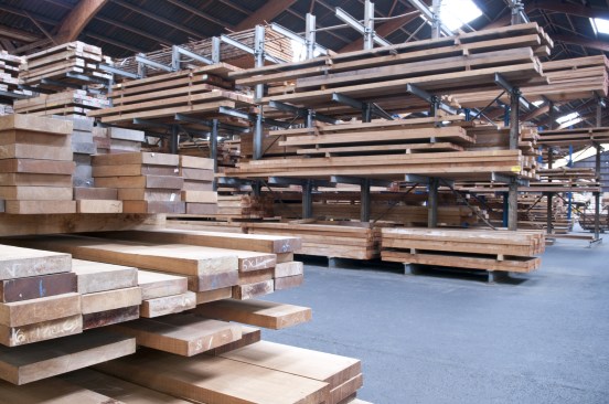

In this column, we recently covered softwood lumber—both framing and finish material that you get from a standard lumberyard or retail building material outlet (see “A Trip to the Lumberyard,” Apr/21). While you can find a limited selection of hardwood at the big box stores, you’re better off buying hardwood lumber and moldings from a specialty hardwood and millwork dealer. Even a small dealer will usually have a larger selection of hardwood species and molding profiles, and you have a lot more control over the quality.

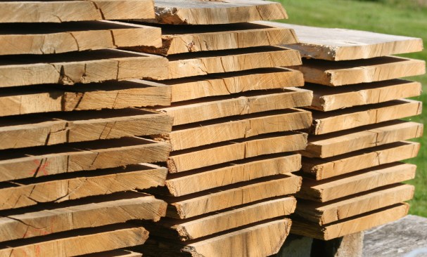

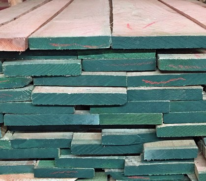

Buying hardwood is usually a completely different process from running to the lumberyard. For one thing, the largest selection of woods is usually rough-surfaced material. Often, the hardwood dealer will receive bundles from a mill that include boards ripped from the same tree, and these remain stacked together so you have a better chance to match the grain and tone of the boards. This rough material is often sold by the board foot, which gets tallied up first, and then if you want the shop to dimension any of it, you pay for that as a separate charge. We’ll come back to that, but first let’s cover some basics.
Rough Lumber Sizing
Rough-cut lumber is sized by thickness in 1/4-inch increments: 4/4 (called out as “four quarter”) stock is one inch thick, 5/4 is 1 1/4 inches thick, 6/4 is 1 1/2 inches thick, 8/4 is 2 inches thick, and so on. It’s an odd convention established by the National Hardwood Lumber Association (NHLA), which has been using the system since the organization was founded in 1898. But there was good reason for it then: In an old sawmill, the sawyer could control the bed of the saw with a lever that ratcheted the log ahead of the blade between each pass. Four clicks on the ratchet equaled 1 inch; five clicks, 1 1/4; six clicks, 1 1/2; and so on.
While the thickness of most rough lumber is given in quarter sizes, it can also apply to dressed sizes. Rough-cut boards are typically surfaced (run through a thickness planer) by shaving off about 3/32 inch per side, making the dressed thickness a total of 3/16 inch thinner. So the “dimensioned,” or “dressed,” thickness for 4/4 lumber at the time of milling is 13/16 inches; for 5/4 surfaces, it’s 1 1/16 inches; for 6/4, 1 5/16 inches; for 8/4, 1 13/16 inches; and so on. Most carpenters will refer to dressed 5/4 material as “five quarter” but usually call dressed 4/4 “1-by” material. Also remember that the dressed thickness stated here is at the time of milling and that the lumber can shrink as it dries or swell as it absorbs moisture. So, for example, a dressed 5/4 board might be 1 1/8 inches thick or 1 inch thick, depending on site conditions. When using the material on site, always check your actual dimensions.

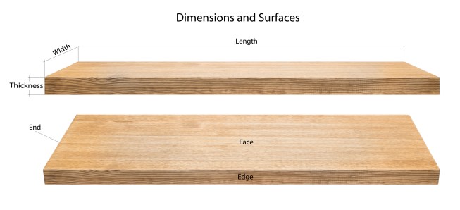

When rough hardwood is purchased, it is typically priced by the board foot, with an upcharge for finishing. To sort out pricing and finishing, be sure you are clear on the terminology for board dimensions and surfaces.

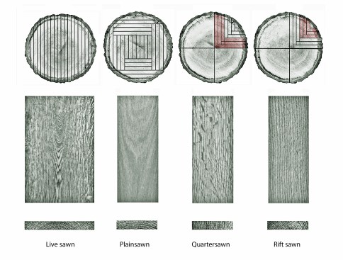

How a board is cut from a log will have a notable effect on the grain pattern of the face, as well as on how dimensionally stable a board is—that is, how likely it is to warp with changes in moisture content. The hardwood dealer knows the cut from the mill and will sort and price the lumber accordingly, but for most of us, it is difficult to see the grain on a rough board. If you want to see and evaluate the grain pattern for yourself, you can carry a low-angle block plane with you. Most dealers will not mind if you smooth a corner of a board face to reveal and verify the grain.
Live sawn is the easiest way to mill a log. The log is sliced up from one side to the other, so you get a variety of grain patterns, depending on which way the growth rings are oriented at any particular point. A few of the boards near the center will have mostly vertical grain, but on either side of center are a variety of boards that will react differently as the wood absorbs moisture or dries. Live-sawn lumber is the easiest material to use if you are trying to match grain.
Plainsawn lumber is milled to maximize the yield from the log. Most of the boards will be flatsawn, revealing the classic “cathedral” grain pattern (see photo illustration, above). The end grain of these boards will mostly have an arc shape, and these boards are the most likely to cup (the grain swells on the face at the top of the arc if the moisture level is higher on that side of the board than on the other).
Quartersawn lumber is usually the most expensive per board foot. It is cut from logs that are first quartered. Each quarter is then milled to keep the grain orientation as vertical as possible through the thickness of the board. Technically, a board with at least 80% of the grain at 60 to 90 degrees from the face of the board qualifies as quartersawn; the material closest to the center has the most “vertical grain” (closest to 90). Quartersawn material is very dimensionally stable, and in woods with strong medullary rays will have a “flecked” grain pattern that is especially prized.
Rift sawn material is cut from the outer portion of quartered logs. In this region of the log, the grain is not as vertical, but the face of the boards will still mostly show the characteristic parallel bands, though not as many flecks as in woods with strong medullary rays. Boards with grain from 30 to 60 degrees from the face qualify as rift-sawn material.

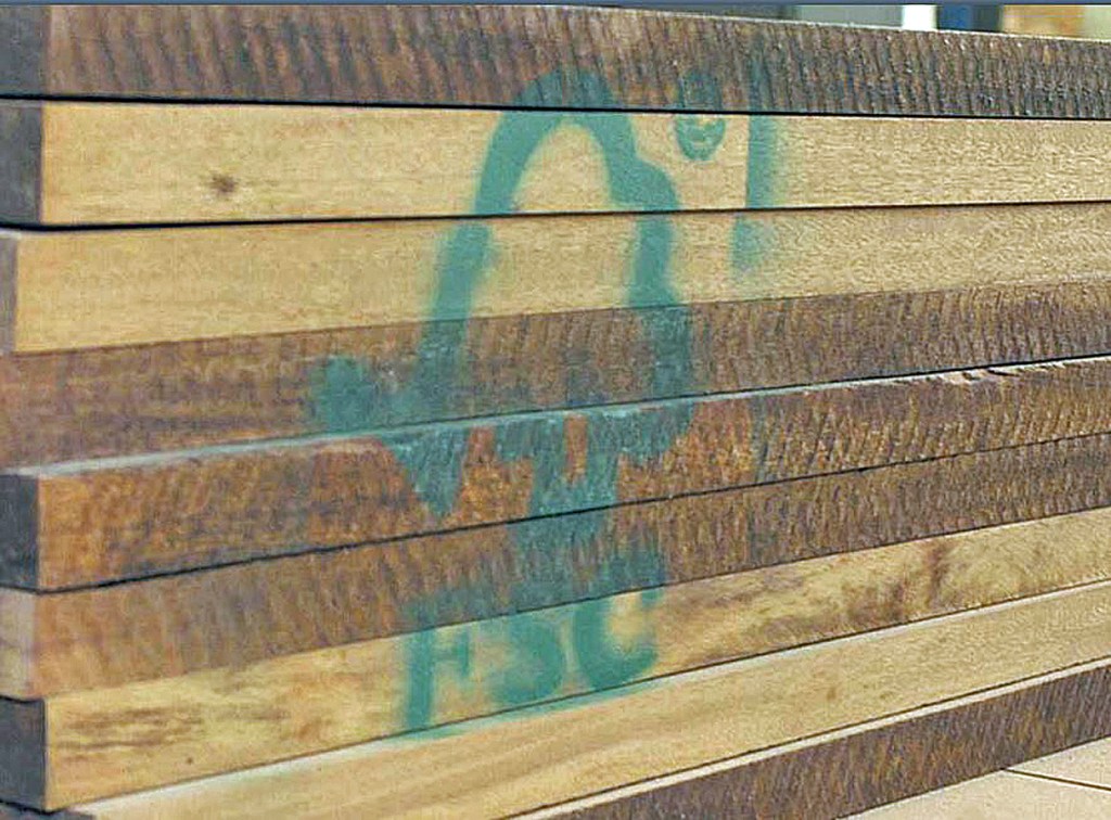

Since a lot of hardwoods come from tropical regions, there has been elevated concern among architects and building owners that wood products come from well-managed forests that do not negatively impact has been of growing concern to a number of building owners and architects in recent years. While this first grew out of a concern for tropical hardwood,s it is a really a concern in all countries, including the U.S. and Canada, where forestry practices can have an outsized impact on things like soil erosion, water quality and wildlife habitat.
Certification by the Forest Stewardship Council (FSC) is one place architects and building owners look to for assurance that wood comes from well-managed forests. In order to carry the FSC stamp, wood products must go through a chain-of-custody certification that validates the entire process of growing, harvesting, and delivering wood provides has environmental, social and economic benefits to all involved (as opposed to such practices as clear-cutting, or excessive skidding without effort to plan or restore skid areas, or even hiring and trucking practices that negatively impacting local economies near in and around forest lands).
While there are now other forest certification systems, the FSC standards are still the most rigorous and the most frequently specified by architects, particularly those working on projects for which they are seeking LEED certification. The LEED requirements do not mandate FSC-certified wood, per se; rather they specify that 100% of forest products used in the building are "legal (noncontroversial) sources;" that 70% are from "responsible sources;" and that the remainder must be certified sources as evidenced by a "chain-of-custody certification." FSC certification proves to be one of the easiest ways to demonstrate all three LEED requirements.
