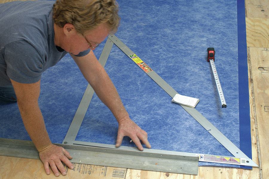

Tile Membranes
Water can penetrate any tile system through the grout joints. Membranes can protect the structure from water leakage and protect the tile from structural movement. Membranes are typically applied beneath tile in wet areas, over cracks and control joints in concrete slabs, as well as at the juncture of dissimilar substrates. When used over a crack or control joint, the grout joints on either side of the crack should be replaced with “soft joints” of foam backer rod and high-quality silicone caulk (Figure C).
Membranes come in liquid and sheet varieties:
One-part membranes are liquid coatings that are poured, brushed, or troweled on. They will work fine for a floor that gets occasional spills, but not for a shower stall.
Two-part membranes are composed of ready-to-use or site-mixed liquids and a fiberglass or polyester fabric (Figure D). They are the most practical choice for waterproofing a complex area like a set of stairs leading into a tub.
CPE membranes are sheet membranes available in rolls of different sizes and thicknesses (Figure E). One type that can be used as a water barrier on walls, floors, and countertops is reinforced with spun polyester. The unreinforced type can be used in shower pans and sunken tubs.

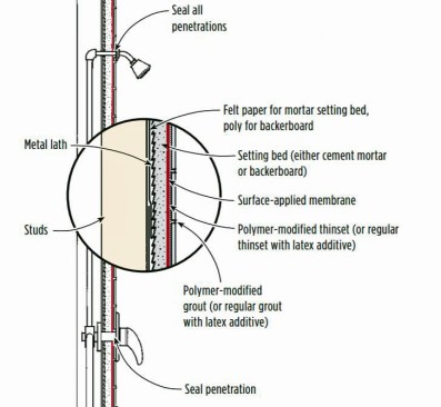

Wall Installations
In dry areas, use standard drywall (not MR board) with either mastic, dry-set, or latex/acrylic-modified mortar.
On wall areas subject to wetting, such as a tub surround, never use moisture-resistant drywall—a.k.a. “M.R. board” or “green board” as a tile substrate. Use a cement backerboard or traditional mortar over a minimum 4-mil poly or 15-lb. felt. Reinforce backerboard joints and corners with thinset mortar and mesh tape. Tile corners, perimeters, and penetrations should be protected with a flexible-sealant expansion joint.
To eliminate most of the absorption problems associated with both mortar-bed and backerboard installations, install a sheet or trowel-applied waterproofing membrane on the surface of the setting bed. This helps isolate the porous setting-bed materials, preventing them from absorbing moisture and germs.
Best practice on tiled walls (as on floors) calls for installation of a sheet or trowel-applied waterproofing membrane over backerboard or a mortar setting bed. An alternative is to use a waterproof backerboard, such as Kerdi-Board (for more, see “Prepping Shower Walls for Tile,” 07/15).

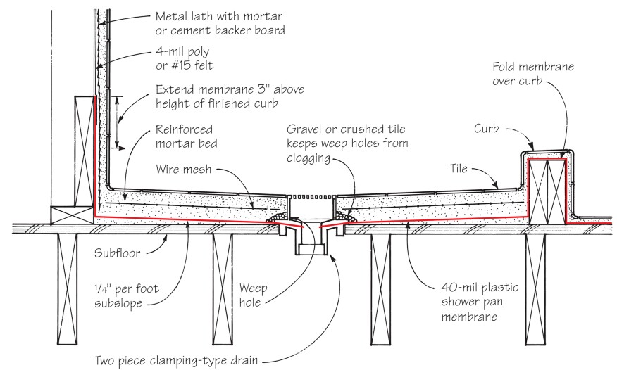

Shower Pans
For a tile shower built on a mortar-bed floor, use a heavy 40-mil plastic pan liner. Wrap it over the curb and seal it in place at the drain with a two-part subdrain assembly, as shown in Figure K.
Some pan liner systems may require a backboard in addition to a membrane over the mortar bed. The installation, however, is relatively straightforward, as the example in this slideshow illustrates.
