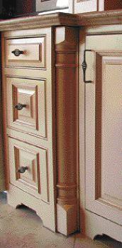

Problem: What can you do with an extra 6 inches in a run of cabinets?
Solutions: With custom cabinets, you can turn extra inches into specialized storage that's tailored to your clients' needs. In this kitchen, storage was added by turning decorative pilasters into pullouts for cooking supplies.
