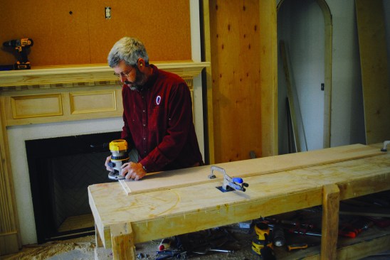

Upper section pieces. Construction begins with rabbeting the vertical pieces for the upper cabinet, using a router.

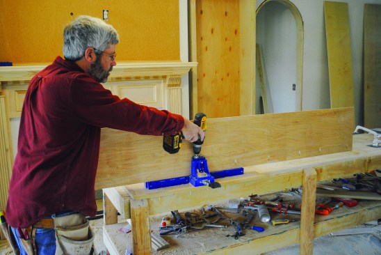

A jig positions holes along the edges for adjustable shelf brackets.

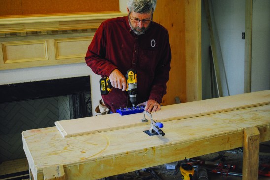

The author drills pocket holes along the front edge of the vertical components for attaching the face frame.

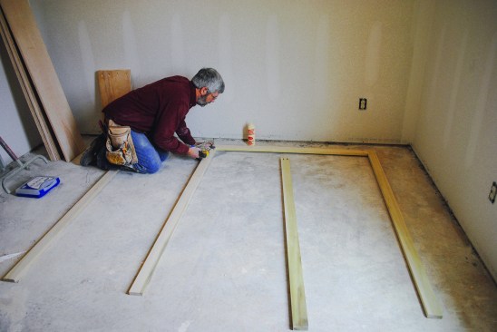

Build the upper section. Working in a large, flat area, the author drives pocket screws to assemble the face frame for the upper section.

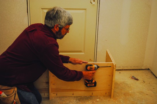

I usually build the cabinet in two parts: a base section and an upper section that sits on top of the base. (The whole cabinet for this project would not have fit through the door in one piece). I make the base cabinet much like a window seat—usually 18 to 20 inches tall for a comfortable seat height, and 16 to 24 inches deep, as space allows. When I include drawers, I try to make the base cabinet 24 inches deep. I made this base cabinet 20 inches deep, and the upper section 12 inches deep.

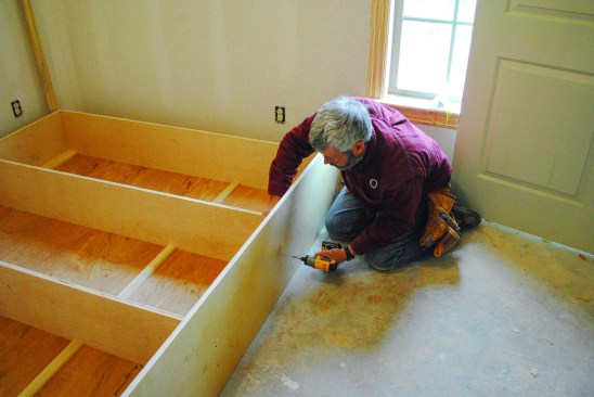

Next  is the bottom of the upper  section. It’s also the seat for  the cubbies, so it’s wider. The  author glues and screws it  to the verticals.

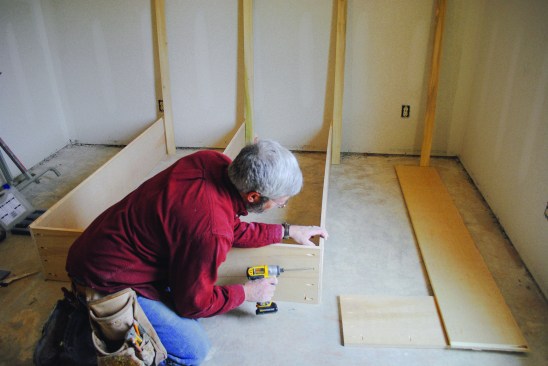

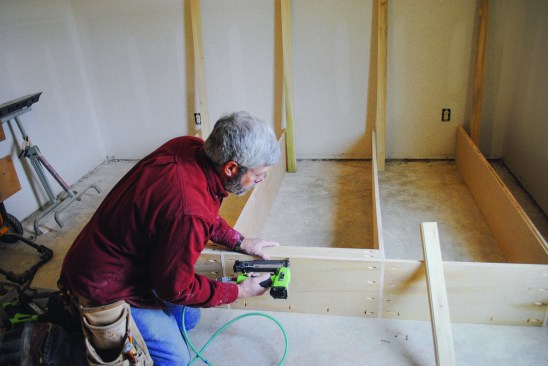

The base section assembles  much like the upper section  except that it is shorter and  deeper. The author attaches  the bottom shelf 4 inches  from the bottom of the box  to create a kick space.
A spreader cleat along the  top of the cabinet provides  attachment for the plywood  back, as well as support for  the upper section when it  is installed. The face frame  attaches to the box with glue  and pocket screws, and  the plywood back completes  the assembly

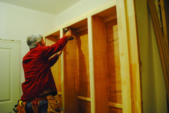

Combined unit. The base section is set in place first, then the upper section sits on top. Screws driven through the upper cleat  and into the wall framing secure the upper cabinet in place.

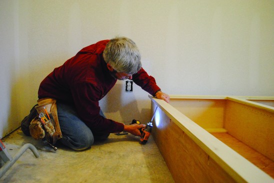

The base also screws to the wall, and then pocket screws join the two sections together.

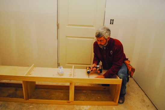

A large back-band molding with a rabbeted edge fits around the edge of the seat; a bullnose softens the edge.

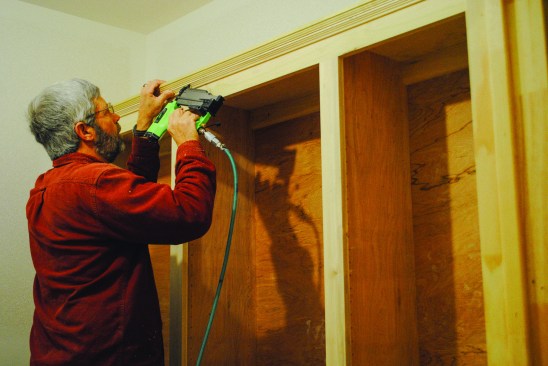

The author uses a cove-and-bead bit to make a two-step trim detail on the top of the upper cabinet. Short pieces of molding finish the back edge of the seat, and the cabinets are ready to be sanded and painted.
