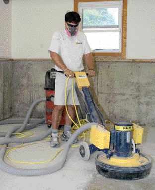

To prepare the garage slab for a two-part polyaspartic coating, the author grinds the surface with 50-grit diamond pads. He uses the larger machine.

We start out by grinding the floor with 50-grit diamond pads in a dust-collecting upright grinder. For edging, we use a smaller grinder mounted on a three-wheeled cart; it too has a dust-collection system. The slab should be free of adhesive and solvent residues. We learned this the hard way on one of our first commercial jobs, a showroom with glue-down carpet. The adhesive residue clogged the diamond pads and made for slow going and long workdays.
In the field and the smaller one around the edges and on the sloping apron near the overhead door. Both are connected to a high-performance dust-collecting vac.
