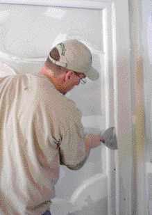

Therefore, on most of my drywall murals I skip the bead and finish the edges by skimming them with a thin coat of all-purpose joint compound. Since all I need to do is fill the dimples and imperfections, I wipe most of the mud off with the knife. Mud doesn’t bond well to dust, so before applying it, I use a shop vac to clean the edges.
Then I tape the seams, spot — or fill — the screwheads, and finish any bead that did go on.

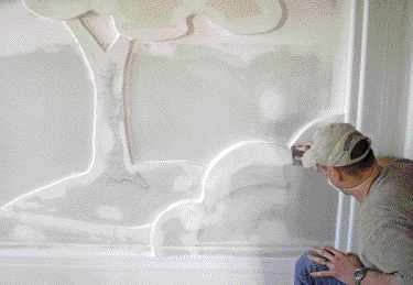

Bead. The straight outer-frame pieces on the basement mural shown here did get bead — a vinyl bullnose. Before stapling it to the wall with a hammer tacker, I sprayed the back with 3M drywall vinyl bead adhesive. A paper-edged tape-on bead would have worked, too. Metal bead, though, wouldn’t have; the bead didn’t land over framing, so there was nothing to nail it to.
Taping and Finishing
The next step is to finish taping the wall. Topping compound is a little easier to sand than most all-purpose joint compounds, so I use it for the last couple of coats. When the mud is dry, I lightly sand the skimmed edges of the cutout pieces with a sanding sponge. Then I vacuum them and use a fine bead of latex caulk to fill the hairline cracks where the layers hit the wall. Caulking this joint is very effective; I have never had trouble with cracking.
Color. The original plan for the basement mural was to use different solid shades for each layer, going from white to gray to black. After experimenting on the tree, however, I ended up creating a more realistic look by varying the shading within each piece.
