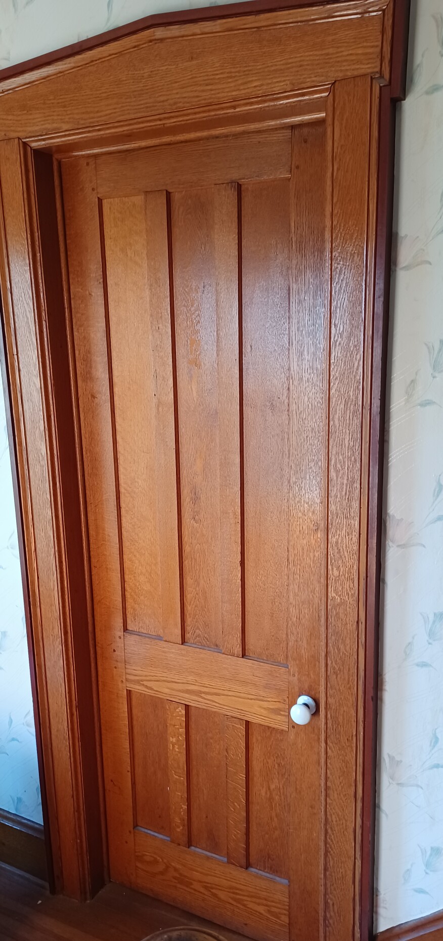

Door and trim from a house built in Franklin, NY, circa 1855. At this time, Chestnut was plentiful, and the wood was used virtually everywhere in the house: as sheathing, plaster lath, interior wall panels, doors, and trim.
Door and trim from a house built in Franklin, N.Y., circa 1855. At this time, chestnut was plentiful, and the wood was used virtually everywhere in the house: as sheathing, plaster lath, interior wall panels, doors, and trim.

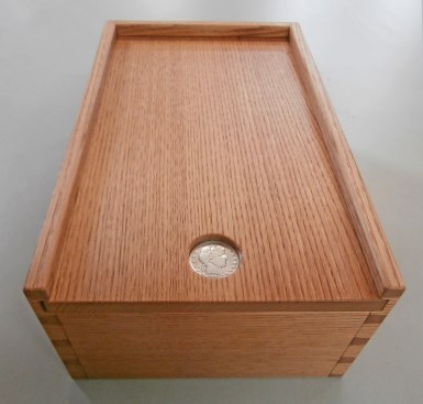

A dovetailed box made by the author from salvaged chestnut wood. The pull is inset with a 1902 half dollar from a time just before the blight
A dovetailed box made by the author from salvaged chestnut wood. The pull is inset with a 1902 half dollar from a time just before the blight.
I once found chestnut floorboards in the attic of a house I restored that had been built circa 1760. The width and tightly spaced growth rings put the age of the trees (likely cut within a mile of the house) at about 200 years, so they were probably saplings around 1560. Many years later, cutting joints on the last board from that attic, I thought, what a survivor—461 years now and hopefully another 100 or more in its new service life. While commissioned cabinet pieces make up most of my work now and I haven’t done much demolition in the past few years, I still come across chestnut boards at architectural salvage yards. I look for boards with straight grain and widely spaced nail holes, looking to make the largest possible clear cuts. The thin strips are good for banding and picture frames, and the wider pieces for dovetailed boxes and drawers. Each little project becomes my respectful meditation on a once great tree.
