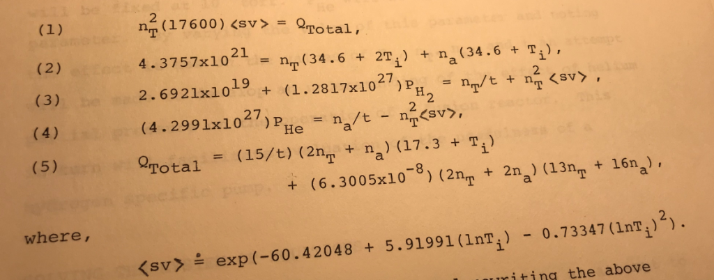

Dynamic problems are the fun ones, but they can have equations that look like this:
That’s a screen grab from my master’s degree research survey, “Considering the Palladium-Membrane Pump for use in Fusion Power Reactors.”
These days, I would prefer to run into a hungry bear deep in the wilderness than be asked to solve those sorts of equations. But, apparently, even back in the day, this was difficult. My conclusion was (paraphrasing) “This model I thought up sucks, the equations are too difficult to solve, and we should model this process differently.”

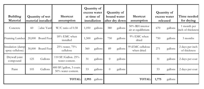

Let’s consider an “average” house. If your building is anything other than average, you’ll have to use your own envelope to figure out how different it is from average.
Take a typical suburban American home: 2,000 SF of floor space plus 500 SF of garage.
Make a few assumptions, scratch out a few calculations on the back of a magazine, and this is what you come up with:
So, the short answer to this week’s question is that there’s about 1,700 gallons of excess water in a house when the keys get turned over. That’s about the same amount of water as a large kiddie pool.

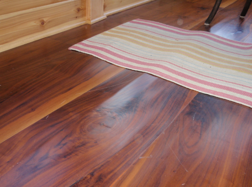

Of course, occasionally something goes wrong because of this excess water thing. Here’s a photo of a nice walnut floor that self-destructed after it was installed over a newly placed concrete slab:
The excess water in the concrete slab dried out and the kiln-dried walnut absorbed it. The expansion of the wood was too great, and it lifted itself off the slab (it was glued down) and broke apart. That was an expensive mistake. First, the slab should have been allowed to dry out for a much greater period, but, more importantly, a vapor barrier (liquid applied, not sheet plastic) should have been installed on top of the slab.

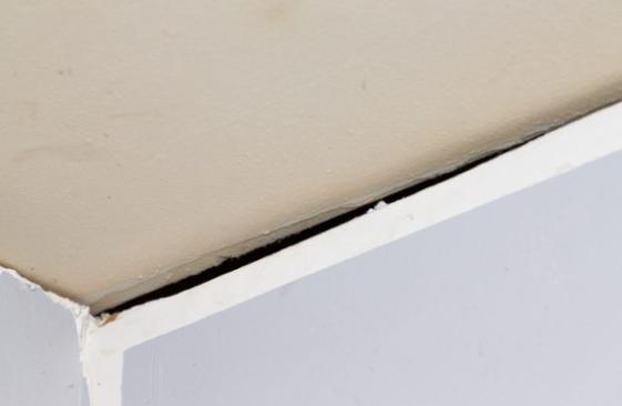

Similarly, lots of money is spent on paint touch-up the year after construction is finished. As the framing lumber dries out, it shrinks, and that causes all sorts of minor imperfections in the drywall finish and connections between drywall and surrounding materials. Sometimes I think this should be added to the scope of new construction projects, but neither homeowners or contractors seem to like this. In any case, it needs to be explained to new homeowners that this is a real thing, not anyone’s fault, and there is a cost associated with it. Below is an extreme example, but you get the idea.
I’m of the opinion that wood trim should never be caulked along its edges where it meets the drywall, but I’ve never been successful at convincing anyone of this. I’m also of the opinion that we should quirk all our trim (light and shade, I suppose, for you architects).
These sorts of small details at least allow things to move around without bankrupting the contractor or causing your reputation to get flushed.
