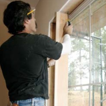

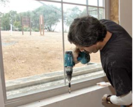

We set screws so their heads are in line with the outside edge of the window jamb. The idea is to put them as close as possible to the window but still get them in straight. The width of the screw gun prevents us from putting them much closer than 1 1/2 inches away; we can't get them nearer without putting them in at an angle. I don't worry about shimming the opposite edge of the extension because it will be secured by a casing.

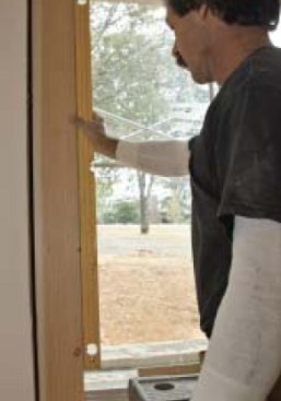

We start by sinking a row of screws along all four sides of the opening — one screw at each end, one in the middle, and enough in between so no two are more than 12 inches apart. Using a square-cut block of wood as a measuring device, I align the bottom screws first. I put the edge of the block against the jamb and land the end of it on the screw. If the screw is installed correctly, the end of the block will be flush to the edge of the jamb. If the block is too high, I drive the screw deeper; if it's too low, I back the screw out. A screw gun works well for the initial installation, but a screwdriver is better for fine adjustments.

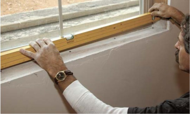

Once the heads of the end screws are aligned with the jambs, I place a straightedge (in this case a level) on top of them. I then raise or lower the rest of the screws so that their heads just touch the bottom of the straightedge. The screwheads now form a straight line that is aligned with the edge of the window. It's great if the line turns out to be perfectly level, but more important that it be parallel to the jamb. If the screws read badly out of plumb or level, I know the window was poorly installed. If the window is seriously out of whack, the framer needs to come back and reset it so it's plumb, level, and square.

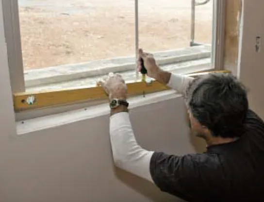

The next step is to repeat this process up one side of the window. This window was too tall for a 4-foot level to work as the straightedge, so we used a straight piece of wood instead.
If the window was installed correctly, the level will read plumb when placed against the straightedge.

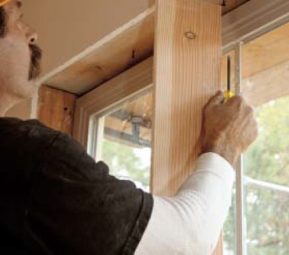

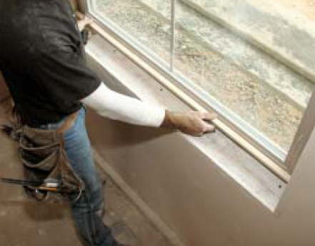

At this point, the screwheads around the opening form straight lines that are aligned with the outside edges of the window jamb. To install the jamb extension, we simply fit it between the screwheads.
If the jamb stock is straight, the jamb unit will slip right in and there will be no slop between it and the screwheads. If the jamb stock is bowed, we might have to tap the unit into position.

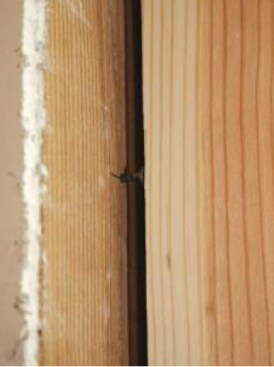

Usually it's a perfect fit, but if a screw is high the jamb extension will encroach on the 1/2-inch reveal. We fix this by putting a block over the high spot and hitting it with a hammer, slightly burying the screwhead in the back of the extension.
Our last step is nailing off the jamb extension. Since we want to nail near the screwheads, we mark their locations in pencil on the jamb. That way, we won't accidentally nail where there is no "shim."

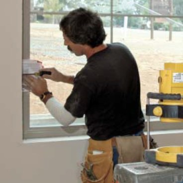

Sometimes we set the screwheads to a laser line rather than to a block. With single windows, using a laser is no faster than using a block; but with clustered (ganged) windows, it's a significant time-saver.
Although clustered windows are rarely installed in perfectly straight lines, the jamb extensions on these units must be perfectly aligned; if they're not, variations will show up in the casing reveal. Since the laser beam can span multiple windows at the same time, we use it to align adjoining jamb extensions.

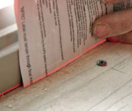

To begin, we set up the laser so that the horizontal beam lands on — or just clips — the bottom edge of a jamb. The beam represents the top of the screwhead and the back of the jamb extension. If the windows are not perfectly level or aligned, the beam will be high in some places and low in others. We adjust its height until we have a compromise that works for all the windows. Then we set screwheads to this line across the bottom of the openings — much as we do when we use a block, except now we're gauging the height of the heads with a laser.
The trick is to make sure that the beam always has something to land on; otherwise it won't be visible. For example, if the screwhead is below the beam and the window jamb is above it, the beam will disappear into the gap below the window. When that happens, we hold a piece of paper — in this case a window label — behind the screw so that we can see the beam.
We then raise or lower the screwhead until it splits the beam. The lower half of the beam will hit the screwhead and the upper half will be visible on the paper. We repeat this process up the side of the window.
