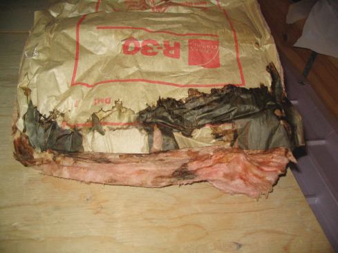

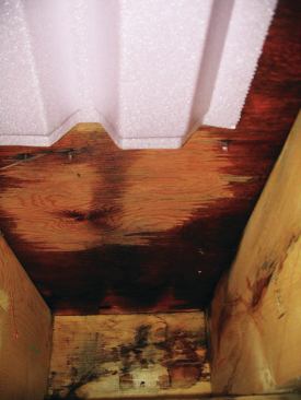

The Kraft facing on the insulation looked fine, but when I pulled the insulation out of a couple of rafter bays, I found saturated fiberglass and saturated plywood roof sheathing. In some bays, there was actually frost on the sheathing and insulation.

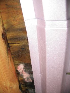

Vent chutes were installed in the rafter bays, but solid blocking between the rafters along the top of the exterior wall prevented any ventilation air from circulating. There were no intake vents along the eaves and there was no ridge vent at the roof peak.
Moisture-meter readings of the plywood ranged from 26% to 76%. Staining on the sides of the rafters showed where water had dripped down to the ceiling level. I removed a recessed light from the tongue-and-groove ceiling area of the loft and pushed the insulation aside. The moisture in the sheathing measured between 24% and 35%.
I didn’t cut into the drywall around the skylights to check, but I surmised that the same condensation problem was occurring in those rafter bays too. Either humid air was piggybacking on air leaks or moisture was diffusing through the drywall and condensing on the cold underside of the roof sheathing. What appeared to be roof leaks at the skylights were most likely condensed water saturating the drywall and dripping through the perimeter trim.
