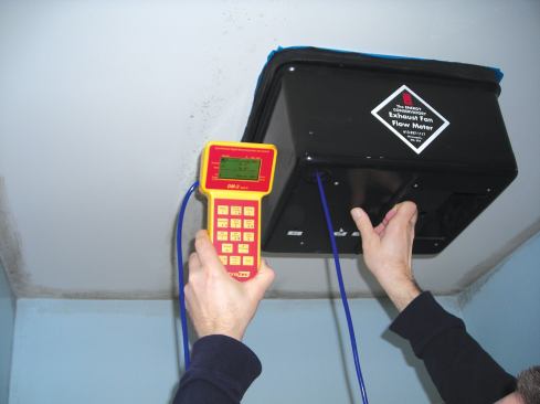

Of the two fans in this house, one seemed to be adequately sized, and the other too small. Yet both bathrooms had mold problems. Because I do energy assessments, I have a blower door and a couple of manometers, which measure air pressure. A manometer used in conjunction with an exhaust-fan flow hood can measure the air pressure at the bath fans to within 10 percent accuracy.
The flow hood (the Exhaust Fan Flow Meter, energyconservatory.com) is basically a plastic pan you place around the fan (or register); it has weatherstripping on the edges to make a tight seal and a sliding door that adjusts to accommodate various fan sizes. With the fan running, the manometer measures the air pressure inside the hood with respect to pressure in the bathroom, from which you can calculate the airflow between the two areas of pressure. I found that the master-bath fan was drawing 41 cfm and the shared-bath fan 43 cfm.
If you don’t have a manometer, there’s a simple test you can do: Turn on the fan and see if it can hold a single sheet of dry toilet tissue against the grill. If so, the fan is probably drawing at least 40 cfm.

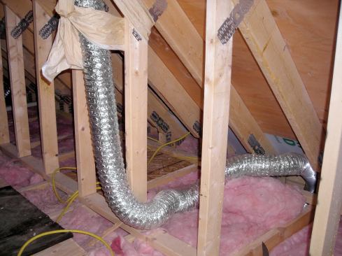

On climbing into the attic, I discovered that the two fans were connected to the same roof jack via a tee with no dampers in it – the master fan through a run of flex duct more than 23 feet long, the shared-bath fan through 26 feet of flex duct. It looked like the builder had tried to minimize the number of roof penetrations and to conceal the vent on the back of the house.
There were also long runs of unsupported duct – places where condensed moisture could settle in the low spots. I’ve seen cases where these puddles freeze into solid blocks during the winter and block the airflow. (Also, in rare cases, standing water can spawn Legionnaires’ Disease, so it’s a good idea to be careful and wear a respirator when removing flex duct.)

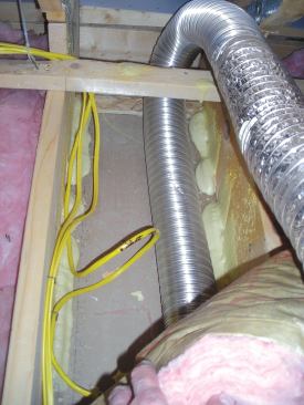

Where the flex duct exited the fans, the fiberglass batt insulation had been loosely stuffed over the top. This made it easy for cold attic air to get underneath the batts, creating a cold ceiling where bathroom moisture condensed and caused mold to grow. It also explained the oblong patch of mold in the center of the shared bath ceiling.
