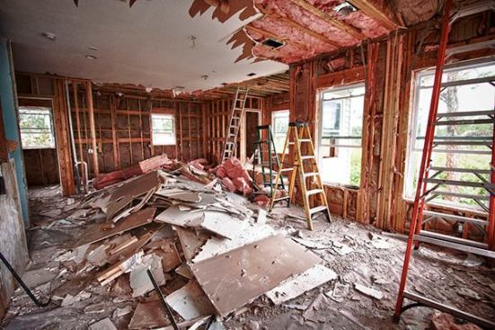

Chinese drywall remediation is both a technical and a management challenge. The crew has to take out integral components of the house—drywall, wiring, plumbing—that were never intended to come out, all while protecting and preserving the rest of the house. And then they have to restore the house to a like-new condition.

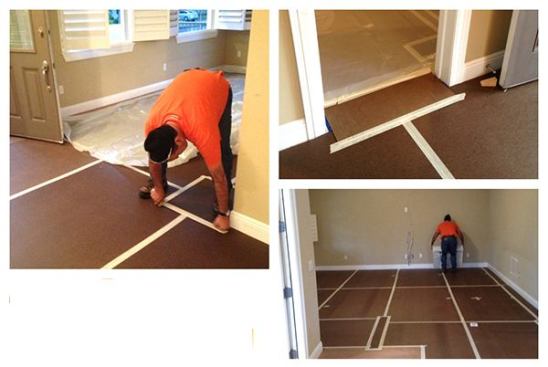

Details count. “I have a full task list of everything that has to be photographed before we begin,” Stockland says. “I have a full task list for everything that has to be measured, and how we measure it. I have photograph files to show my guys: ‘This is how we protect swing doors, this is how we protect thresholds.’ There are very specific ways that I do it. And then it makes it easy for me to train different people on it.”

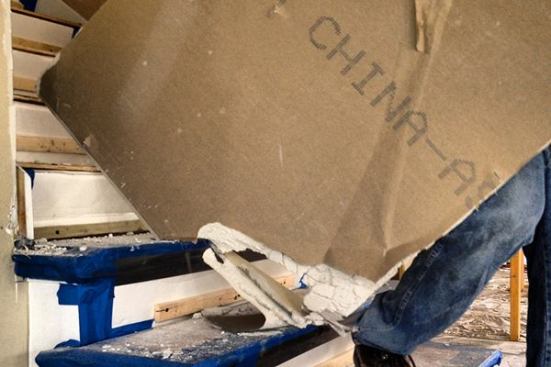

The work starts with “salvage and protection”—removing items that can be saved and reinstalled, and protecting items that will stay in place throughout the demolition, cleaning, and reconstruction. “That takes about a week,” says Stockland. An example: protecting staircases. As with other techniques, Stockland’s methods have developed over time. In a video published online in 2011, Stockland shows how his crew applies protective foam board to treads and risers (“Chinese Drywall Stair Protection“). But he says he does it differently now: “I was putting half inch foam board on the treads, but I didn’t like how that was actually surviving. So I changed from half-inch foam board to 7/16-inch OSB. But then the OSB wasn’t surviving real well on the nosing, so I changed that to plywood.”

When the house isn’t covered by the Knauf settlement, there’s another wrinkle: saving the evidence. Federal Judge Eldon Fallon has issued a blanket order describing how evidence must be collected and preserved in houses that are worked on before a court judgment is entered (see “Pre-Trial Order No. 1b, Preservation of Physical Evidence“). Stockland explains: “The demolition has to be done in a very orderly way, because every single piece of drywall that comes out of that house, down to about 12 inches by 12 inches, has to be photographed and documented. You can’t have guys off doing demo in a different part of the house. Your crew has specific assignments, and you work your way through the house from room to room, wall by wall, documenting the entire thing as you go.” Stockland has posted a video description of his evidence preservation practices on YouTube.

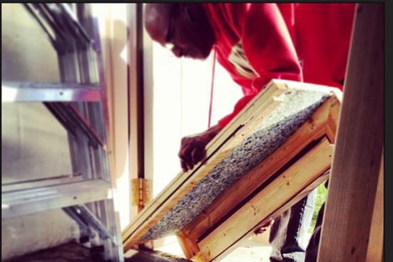

Stockland ends up with a huge file of digital images of the work. But that’s not all: “Judge Fallon also requires that you keep actual bagged samples of drywall that you remove from the home,” he says. “As you can imagine, if you were in my situation, you wouldn’t want to hang onto that stuff for any longer than you have to. So you turn the bagged samples and the image files over to the homeowners, with a copy of the evidence protection order, and you give a copy of the order to their attorneys, also.”
