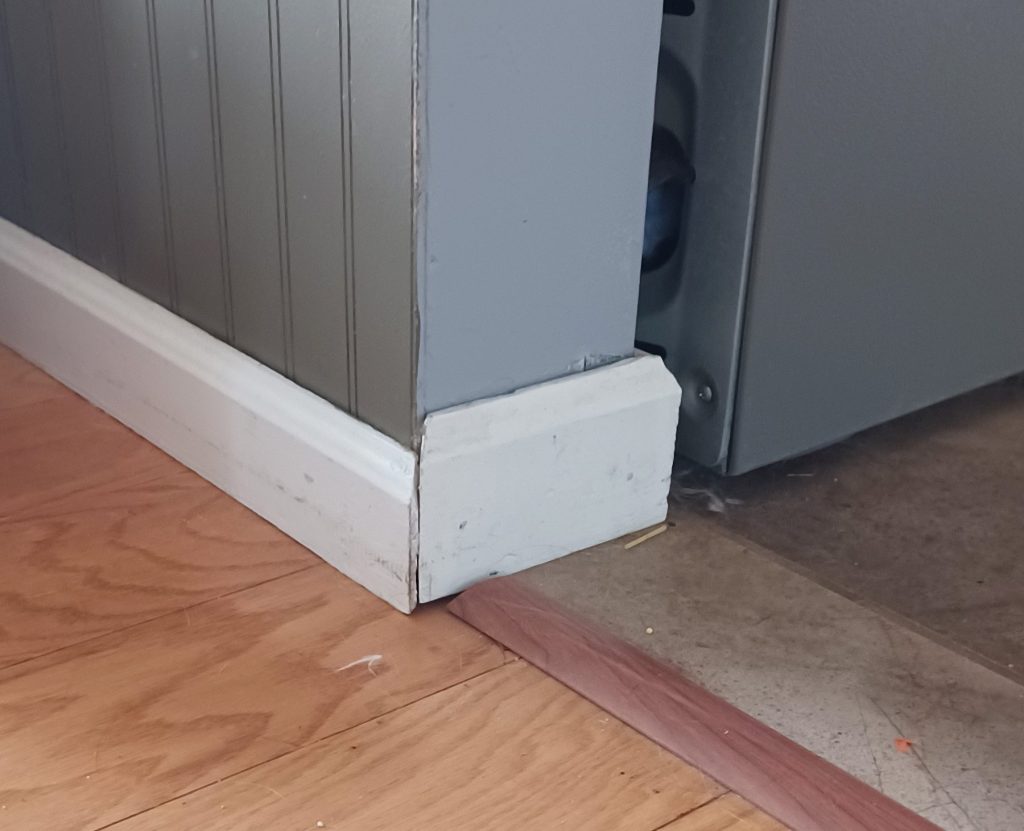

A big part of a trim carpenter’s job is problem solving. A lot of DIY carpenters don’t do this well, as evidenced when JLC editor Clayton DeKorne moved into a new house last April. The previous homeowner had opted to finish the house himself with the very least expensive materials. He did marginally OK with ordinary casing and baseboard but left eyesores wherever floor height changed or moldings needed to terminate or change level, and .
What follows are a series of photos Clay took in the house, along with photos I took in my shop after I dummied up scrap material to demonstrate the joints I would have used to resolve these transitions on one of my jobs. For some of these, I used a simple door stop to mimic the existing trim. But in other cases, the only scrap I had was leftover custom or salvaged trim, which is commentary in itself.

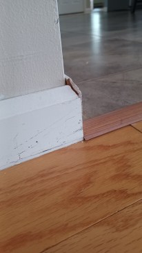

Floor Changes

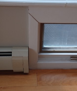

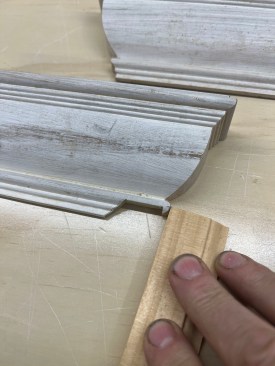

Molding Termination

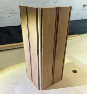

Gentle Outside Corner

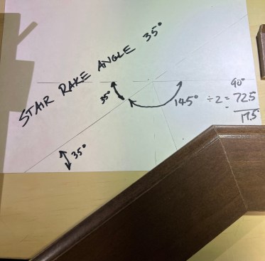

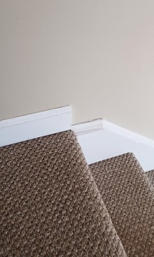

Stair Transitions
