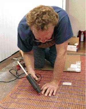

After removing all the old nails and vacuuming the 11/8-inch-thick plywood subfloor, I began the installation by applying a primer — a companion product to the SLC used on this job — with a long-necked roller. This SLC, Level Quik RS (Custom Building Products, 800/272-8786; www.custombuildingproducts.com) has a high compressive strength — about 2,500 psi — but its bond strength is very low unless the primer is used. The primer soaks in quickly, so the work can continue as long as I don’t get any dust or dirt on the plywood.
Floor Prep
Figure 2.Before installing the heat mat, the author rolls a primer on the clean subfloor to ensure good adhesion of the self-leveling compound. After nailing down diamond mesh, he rolls out the radiant mat.
I prefer to use an SLC that requires the addition of a reinforcing mesh, which adds considerable tensile strength to the installation and helps prevent tile cracking. The only downside of the mesh is that is sharp enough to damage the resistance matting if I’m not careful. Actually, this matting is quite strong and should hold up to the usual job-site abuses. Still, it’s a good idea to use the alarm device to make sure the wires are intact.
