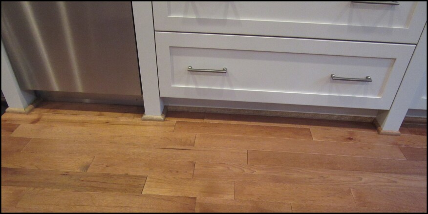

When kitchen floors are reasonably level, shimming cabinets up to match the high point is simple and quick. Under-counter appliances and full-height cabinets normally fit just fine.

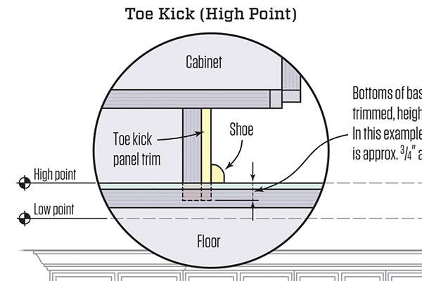

Cabinets usually have vertical toe-kick trim that can be scribed to an uneven floor to cover any gaps. Shoe molding can also be used to cover a small gap. Either method is easy and quick and leaves enough vertical room for standard under-cabinet appliances.
Shoe molding used to cover a small gap.

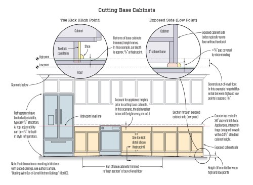

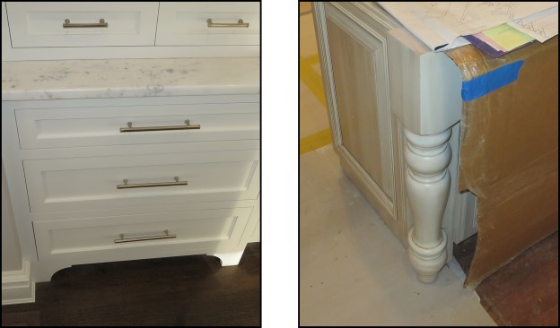

Cut some cabinets. Sometimes, shimming all the cabinets would create an unacceptable gap somewhere. For example, the low point could be so much lower that the gap is too high for shoe molding to hide. Cabinet sides usually don’t have separate toe-kick trim, so making them look good can be hard if a gap is big. And lately, many cabinets have “furniture base” decorative elements that run to the floor and do not gracefully lend themselves to trimming out the bottom. For example, decorative legs with round profiles in the 2-to-5-inch-diameter range wouldn’t look right with a curved shoe molding, to say nothing of time to execute such a solution. Similarly, some decorative toe kicks have angled shapes that don’t look good if trim is installed around them. In these cases, we often trim the bottoms off the cabinets at the highest point in the run, so the decorative parts can land on the floor. Sometimes, we even cut off the bottom of the furniture legs on part of the run; though not ideal, it looks better than adding shoe molding. If the high point is at the back of the cabinets (as it often is), we may not need to modify the fronts much at all.
Many cabinets have “furniture base” decorative elements that run to the floor and do not gracefully lend themselves to trimming out the bottom (left). Decorative legs can be hard to adjust for floor heights (right). Adding shoe molding to a round post like this would be time-consuming.
Be careful with appliance spaces, though. Standard under-counter spaces are 34 1/2 inches tall, and when we cut cabinets, the available space gets smaller. Different appliance models can require different heights. The first kitchen I ever installed had a dishwasher that required 34 3/8 inches of vertical space, and when I installed the cabinets at 34 1/8 inches, it was a heartbreaker.

If the amount the floor is out of level is more than the height of shoe molding (typically about 3/4 inch), we usually trim the bottoms off some cabinets at the high point of the floor. It’s important to verify the appliances will fit. Cutting more than 1/2 inch can lead to trouble when appliances are changed out later, even if the model being replaced fit fine.

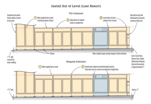

How to install out of level. We’ve found two basic approaches. The first is to tilt all the boxes out of level as you go along. The second is to install each box plumb but drop each one a little bit so the top corners are in a straight line that slopes up or down as needed.
I tend to prefer the first method. I strike a line on the wall at the angle needed, and run the backs of the cabinets to it, then level each side separately and watch the door reveals to be sure the cabinet face is square. As mentioned, it’s easy to make mistakes. The front of a cabinet can easily be 1/32 inch or even 1/16 inch different from the back, and we can’t easily check with our normal levels because the cabinet is supposed to be tilted so the level won’t read right anyway.

When forced to go out of level, we use one of two methods: One is to tilt all the boxes out of level as we go along; the second is to install each box plumb but step the units so the top corners are in a straight line that slopes up or down as needed.
I am lucky to work with Abidan Munoz, a fantastic carpenter who showed me the second method. He strikes his out-of-level line on the wall but installs each box plumb and square with the high corner touching the line. Adjacent cabinets don’t line up perfectly, but this can be finessed with a bead of caulk under the countertop, or with a belt sander. Either way, you can get out of a lot of trouble with this technique. I’ve seen Abidan use it on a 14-foot run that was about 15/8 inches out of level, with floor-to-ceiling cabinets at each end, furniture bases, and a crown that was difficult to adapt to height differences. He made up half the difference in the crown, and the rest in the boxes.
