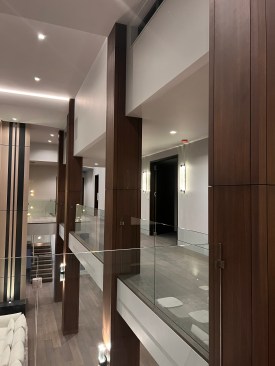

In my company, we not only enjoy figuring out how to do things that we haven’t done before, but we also thrive on it. On a recent project, the plans called for glass railings on the house’s interior and exterior balconies and interior stairs. The architects’ renderings showed glass panels that seemed to emerge out of the hardwood flooring, capped with what appeared to be a sleek wood or metal top rail. While this was a cool detail, it was also intimidating because we had no experience installing glass railings. In this article, I’ll walk through the steps we took to acquire the knowledge needed and implement what proved to be a dramatic design element on a large custom home we have been working on for the last several years.

Meanwhile, we were still having weekly client meetings, which gave us a chance to check in with the clients’ expectations. After looking at numerous photos of glass railing styles, they confirmed that they preferred the look in the renderings.

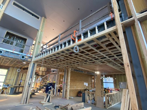

Our next move was to order the glass channel. This product can be selected with a fascia mount (holes in the side), a surface mount (holes in the bottom), or an undrilled track. A fascia mount worked best for us. The lag screws would go right into the 2-by that capped the steel beams that ran the perimeter of the balcony locations.
We couldn’t move forward with the hardwood flooring until we installed the glass. We had already been planning to set the doors and trim on the finished floor, so this accelerated our timetable for the glass installation. This also meant having to protect the glass for the remainder of the project.
Being unfamiliar with glass railings, we consulted with our structural engineer about the mounting location. After he reviewed the CR Laurence specs, he confirmed that using the track with the ½-inch-thick tempered glass and aluminum rail would meet the lateral requirements for guardrails. But with a single mechanical fastener in the fascia mount vertically (they were spaced 12 inches on-center running horizontally), we were still concerned that the assembly could create a hinge point and allow more flex in the glass than we would like. We brainstormed with our framer and steel fabricator on ways to reinforce this connection, hoping to take advantage of some steel I-beams beneath the channel location. Because the glass channel was aluminum, we couldn’t simply weld it to the steel beams, so (after running it by the engineer) we settled on welding pieces of steel angle to the beams directly under the channel to lock it in place.

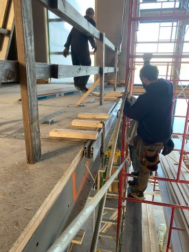

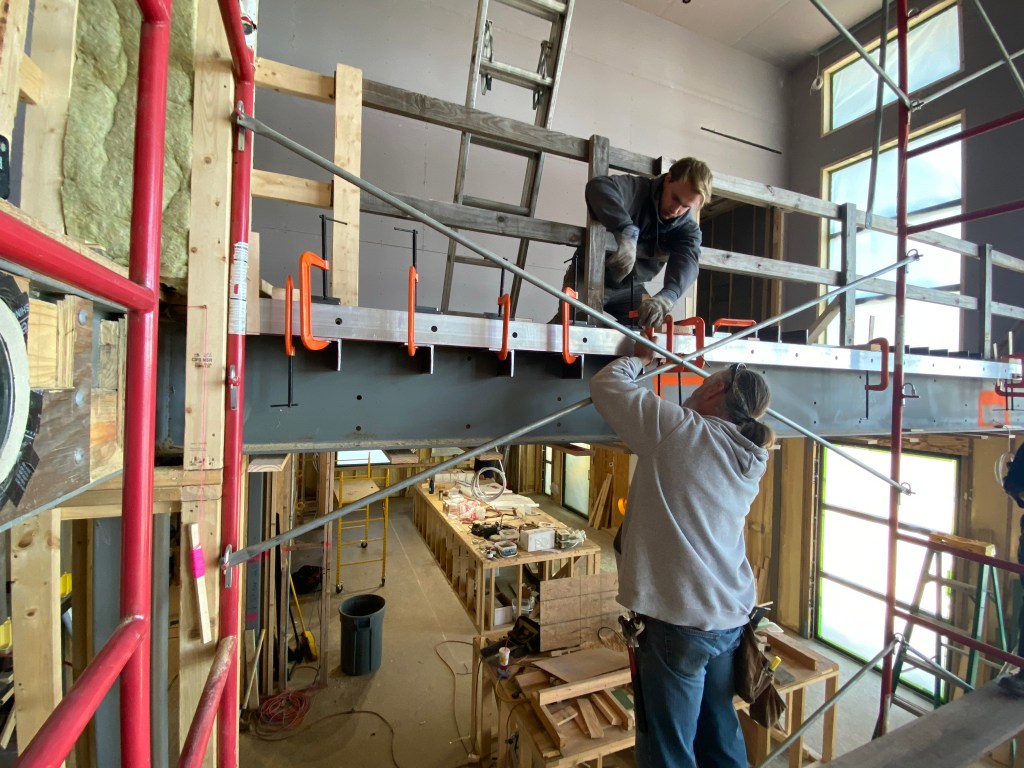

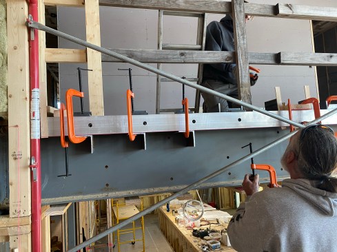

Once we had the glass channel in hand, we tasked the carpenters on site with installing it. Precision would be key when it came to the placement of the heavy aluminum bottom rail. The lead framer came up with the idea of fastening 2×4 scrap blocking to the top of the subfloor extending out over the balcony. This would allow them to push the channel up tight knowing it would be flush with the subfloor. Once they installed the blocking, the framers used large C-clamps to hold the channel pieces in place, making minor adjustments with shims as needed. We cut the channel on a 12‑inch miter saw with a Diablo non-ferrous blade, slow and steady.

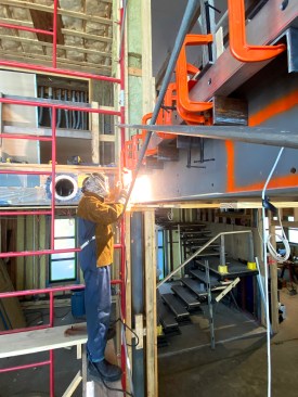

The welders followed suit, using the C-clamps to sandwich the channel between some scrap steel above and their small pieces of ¼-inch steel below, welding them in place. It was cool to watch as the carpenters and welders worked together to set the channel and steel angles. They were able to knock out the main balcony in just about one day.

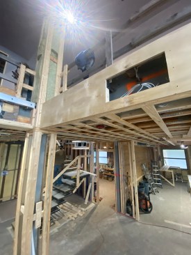

With all the steel and glass channels in place, the carpenters boxed out around the steel beams to prepare them for wallboard. At the same time, we worked with the glazers to create an equivalent panel layout for any area that would take more than two panels. The panels would all be around 48 to 60 inches to keep their fabrication and installation manageable. We also planned for about a ¼-inch gap between panels and at each wall or column termination.

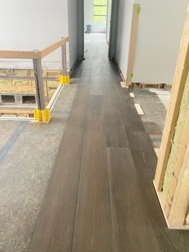

We progressed through the plaster walls and ceilings in these spaces until the glass arrived, and the glazers could set all the panels. This process went smoothly and set us up to start on the hardwood flooring. Since we had established a plan for the hardwood flooring adjacent to the glass, we were ready to go.

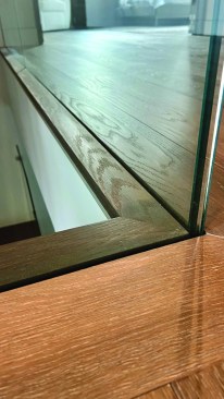

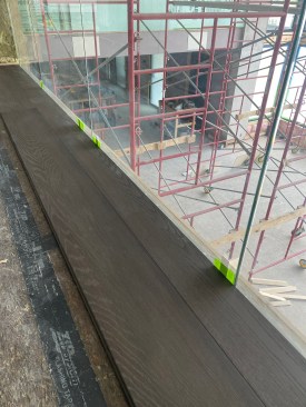

We started the hardwood on the long hallway upstairs, which was also the longest run of glass. This would allow us to establish parallel lines between the glass and hardwood. One other detail we discussed with the hardwood flooring installers was how much space to leave between the glass and the wood to allow for expansion and contraction throughout seasonal swings in humidity. With the ⅛-inch gap the flooring installers wanted, the aluminum track would be visible, which was not the look our team was going for. On a modern project like this, tolerances are often tight, and since there aren’t a lot of ways to hide imperfections, we compromised and agreed on a ⅟₁₆‑inch space between the glass and wood to maintain the appearance of a tight fit. To keep the spacing consistent, we used some flat plastic shims that our window installers had turned us on to; they come in ⅟₁₆-inch increments and are super handy.
Working Out Details
While we were working through the details of the spacing between the glass and the wood, we realized that the raw edge of the wood would be visible when you stood back and looked down at the base of the glass. The floor manufacturer, Carlisle Wide Plank Flooring, provided us with some additional stain for touch-ups. After cutting their pieces, the installers applied the stain with a rag, gave it a few minutes to dry, and then installed them. The main goal was to darken the wood behind the glass; we all agreed that no finish was necessary.

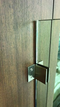

With clients, our answer is always yes; we might not know how we are going to do it, but we figure it out. We went back to the glass hardware supplier and found some stainless steel clips that would fit between glass panels and at any terminations to help stiffen things up. We proceeded to order a few samples to show the client. Once those came in, we mocked them up between some of the already installed glass panels, and the clients gave us the green light to use them everywhere.

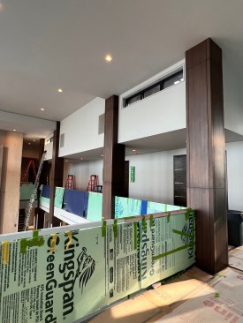

Once all the glass was installed, there was still a lot of construction to complete for the project and protecting the glass was critical. We placed sheets of ½-inch rigid foam on both sides of the panels and capped the vulnerable top edge with 2 inches of rigid foam. We also opted to drop moving blankets over the foam, to minimize wear and tear and add a layer of protection. The foam was removed numerous times as the project went on, to allow for measuring and installing of column facades, plaster work, painting, and such. We took special care to keep the foam clean when it was off. Any foam that took on significant debris, we would replace, to prevent scratching the glass.
Removing the protection from the glass was one of the last things to happen as the job wrapped up. At that time, we installed all the hardware spacer clips. The pieces almost disappear, giving the client the ultra-modern, clean install they were after.
