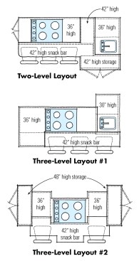

While an island set at a standard 36-in. countertop height will work for most kitchen users, varying countertop heights adds versatility and visual appeal (Figure F). A multiple-level island works well when incorporated with an eating counter (for more on eating counters, see Kitchen Dining Areas, below). However, if your clients do a lot of cooking or baking, one continuous counter may be more useful. There is no “one size fits all” solution.
Lower 30-in.-high counters and cooktops assist shorter users, while a high counter can serve as a snack bar or tall storage and also screens the kitchen mess from outside view.

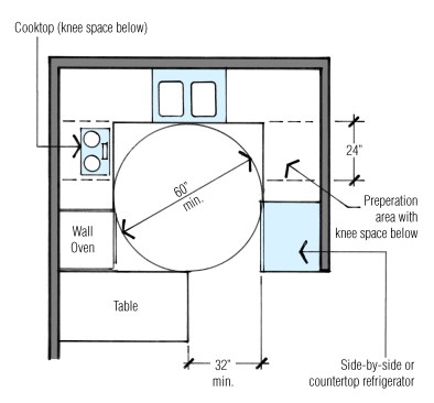

Wheelchair accessibility requires an open floor space of 60 in. minimum in diameter to allow a wheelchair to turn.

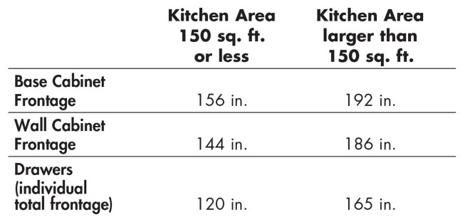

Storage needs vary with family size and shopping and cooking patterns. People who shop once a week need more space than those who shop more frequently. Suggested cabinet storage requirements are summarized in Figure N.
Kitchen cabinet storage will vary with family size and shopping and cooking patterns. The square footage of the kitchen and counter space requirements (Figure O) will also play a role in how much space is available for cabinets. The National Kitchen and Bath Association suggests the minimum cabinet frontage shown above as a starting point for kitchen planning.
Base cabinet frontage. Kitchens under 150 sq. ft. should have at least 156 in. of base cabinet frontage (cabinets must be at least 21 in. deep). For kitchens over 150 sq. ft., the minimum is 192 in. A lazy Susan counts as 30 in.
Wall cabinet frontage. Kitchens under 150 sq. ft. should have at least 144 in. of wall cabinet frontage. For kitchens over 150 sq. ft., the minimum is 186 in. (Don’t count hard to-reach cabinets over a range hood, oven, or refrigerator.)
Drawer frontage. Kitchens under 150 sq. ft. should have at least 120 in. of drawer frontage or roll-out shelf frontage. For kitchens over 150 sq. ft., the minimum is 165 in. (Example: A 21-in. base with three drawers or three roll out shelves counts as 63 in. Drawer cabinets must be at least 21 in. wide to meet this guideline.)

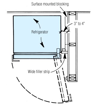

Leave a few inches of clearance when a refrigerator is placed tight to a wall (Figure P). This will allow the door to open wide enough to fully open the refrigerator’s sliding drawers.
When the hinge-side of a refrigerator door is placed tight to a wall, the door may not open wide enough to allow full access to refrigerator compartments. Provide clearance using a filler strip supported by blocking.

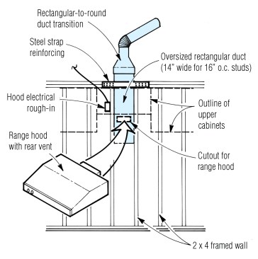

Ventilation hoods. All major appliances used for surface cooking must have a ventilation system with a minimum fan rating of 150 cfm.
Ceiling-mounted ventilation hoods offer the most design flexibility. With an under-cabinet hood, the installation will be easier if the hood is centered on a stud bay (Figure S).
One way to locate the duct for a range hood is to frame a full stud bay in the center of the hood location, then install an oversized duct before drywall goes up. After the cabinets are installed, cut through both drywall and sheet metal to connect the range hood duct.

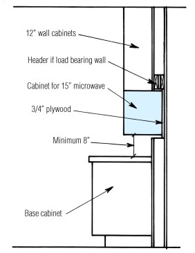

Microwaves. Provide at least 15 in. of landing space below or adjacent to a microwave oven. The bottom of the microwave should be between 24 and 48 in. from the floor (Figure T).
Avoid placing the microwave above a range or cooktop. Although often done, it’s usually too high for comfortable use, and it can create a hazard for children trying to reach the microwave.
Microwave dimensions. Microwaves vary in width; most are between 20 and 24 in. The majority of models are about 15 in. deep. Recessing them a full 3 in. into the wall puts the door in line with a 12-in. cabinet (Figure U).
A recessed cabinet keeps the microwave in line with wall cabinetry. Locate the microwave at least 8 in. above the countertop so the space beneath is usable.
