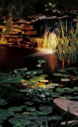

Lighting water features. Nothing looks more dramatic in the landscape than illuminated moving water. Special underwater low-voltage lights are available for lighting a waterfall or casting a glow throughout a pond. These are simple. You can also light the surrounding landscape to highlight the water: Use spotlights to cast light across the stone work in a pond or across a waterfall to shadow the moving water on the rocks beyond. If you have a still water surface, you can light a tree behind the pond to create a reflection of it in the water. Or you can shine a spotlight up a creek, or use a sharp beam spotlight to light a night-blooming water lily. Water features are truly an artist’s canvas — the choices go on and on.
