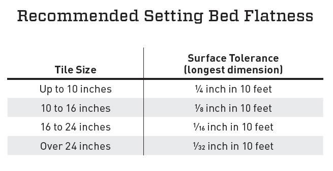

In this table are the recommended tolerances for how much a floor can vary from being perfectly flat, based on the size of the tile. Measurements are taken using a laser level or a long straightedge, and a measuring tape.
