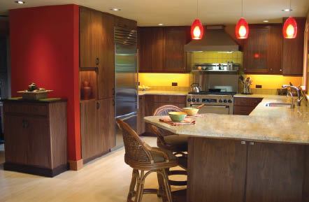

We began our room-stretching plan by demolishing the coat closet next to the basement stairs and building a new, narrower one farther down the hall. This lengthened the kitchen’s footprint by about 3 feet and granted more direct access from the entry.
A long, 36-inch-deep hallway closet that the owners said they no longer needed gave us even more space. We reframed it to accommodate a built-in bookcase on the hallway side, which still left 26 inches for the kitchen — plenty of room to extend the cabinets and create a partial recess for the refrigerator. Next to the refrigerator — behind the new coat closet — we built a shallow pantry.
Doors and Windows
To lengthen the working leg of the kitchen, we replaced the sliding door with a second kitchen window; this allowed us to continue the counter (and lower cabinets) along the exterior wall toward the dining room. A peninsula provides a convenient sitting area for guests.
Because the deck plays such an important role when this couple entertains, we added a third opening in the dining room wall and replaced the sliders with outswing French doors, maximizing the interior’s connection to the backyard.
Tying It All Together
Finally, to unify the kitchen, dining, and living areas, we replaced the original mixture of carpet and tile with bamboo flooring and installed clear-finished vertical-grain fir doors and trim throughout all three spaces. We also had the cabinetmaker build two freestanding cabinets to match the new walnut cabinetry in the kitchen.
