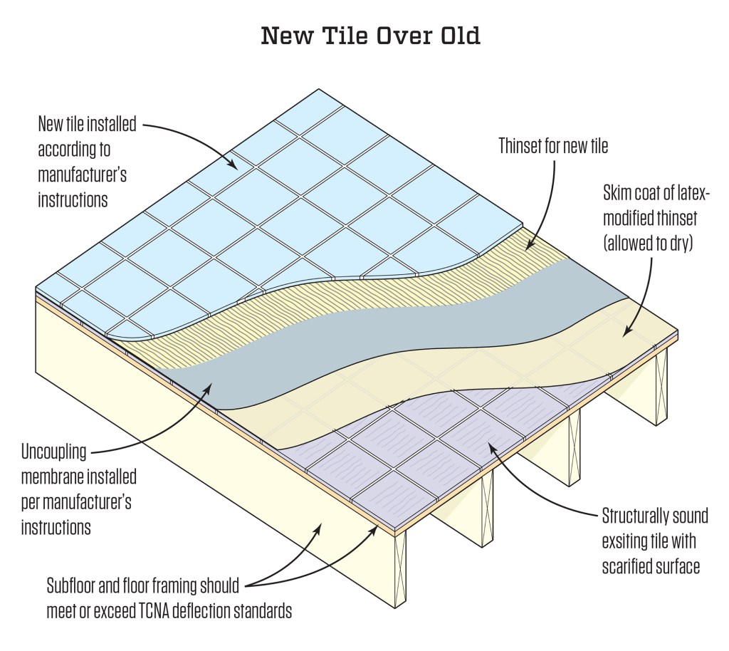

When new tile is installed over a structurally sound tile floor, an uncoupling membrane limits differential movement and keeps the tile from loosening.

To install the new tile over the old, I have one of two approaches, depending on the condition of the tile. For both approaches, I start by scarifying or abrading the surface of the old tile with a grinder outfitted with an aggressive diamond blade. This removes most of the glazed surface from the tile and gives the thinset a better chance of adhering. Then I vacuum and sponge off the surface of the tile.
When the floor is dry, I apply a tight (1/16 to 1/8 inch thick) skim coat of high-quality latex-modified thinset, such as Laticrete 254 Platinum, and let this skim coat sit overnight. If the floor is solid with no cracks or missing grout, the next day I install the new tile over the prepared floor the same way I would tile any other floor, using a high-quality modified thinset, which adheres best in these applications.
If the floor has hairline (nonstructural) cracks in the tile or grout, I install an uncoupling membrane, such as Schluter’s Ditra, over the skim coat of thinset. The membrane bridges any cracks, preventing them from telegraphing up through the surface of the new tile layer. I install the membrane over the dried skim coat that I had applied to the scarified tile, using the thinset recommended by the membrane’s manufacturer. After letting the membrane set overnight, I install the tile the next day.
If you have any doubts about the integrity of the old floor or your ability to assess the floor’s condition, I’d go with the membrane approach. The little bit of extra work and expense is cheap insurance that the new tile floor will not develop any problems in the future.
