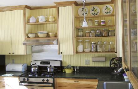

Most of our kitchens — even small, economical ones — now feature a section of stone counter with an undermount sink. Instead of hanging the sink from special fittings drilled into the bottom of the stone after the cabinets are installed, we rabbet the sink opening in the plywood top of the cabinet with a router and straight bit. It’s a fast way to make a strong connection, and it saves a lot of time when installing the countertop.

For the most part, we build our upper cabinets the same way we build our lower ones (particularly those with doors), but we usually don’t bother to install cabinet backs on the uppers. Instead, we install hanging cleats and mount the cabinets directly to the wall, often incorporating the wall finish into the cabinet design.
We also use a lot of open shelving in place of upper cabinets. Open shelves cost less than cabinet boxes, of course, and they’re easier to build on site. They also offer greater flexibility. They can be shallower, for instance, which opens up the counter space a bit, and they can be positioned lower on the wall.
