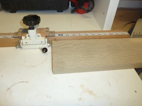

Because there are often many windows of a similar size on a job, I group them together and cut all the components at the same time. A trim package for a typical window consists of a sill nosing or extension, two vertical legs, a head, and an apron. If the window is plumb, level, and square, then the sill and the header trim are one length, and the two legs are another, so I need to calculate only two lengths for each window.
With a cut list in hand, I set the repetitive stop on the miter-saw stand to the appropriate position and cut all the components to length. To minimize confusion and error, I label each piece as it comes off the saw, before prepping the pieces for assembly.

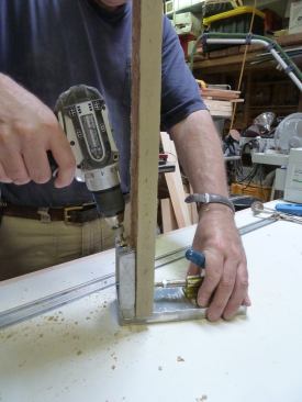

Pocket-screw joinery
For preassembling trim packages for doors and windows, using pocket screws is the fastest and strongest way to join the pieces. Pocket-screwed joints also stay tight in almost any environment. There are several commercially available jigs for drilling the screw holes. We use a Kreg jig, which places the screws at a 15-degree angle to the face of the board. The jig clamps onto the back surface of the material being fastened and a specialized stepped drill bit with a stop collar creates the holes. We usually place one screw every 2 to 3 inches.

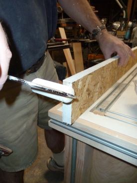

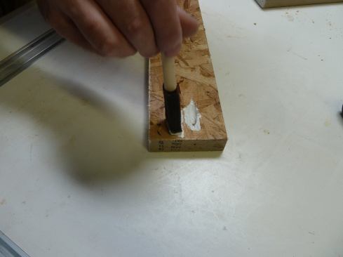

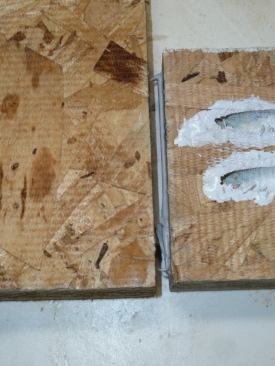

Before the trim is assembled, it’s important to seal any cut ends with quick-drying primer. We also seal the screw holes. Without sealer, exposed fibers can allow moisture to migrate into the material, which can lead to failure of the joint or of the material itself.

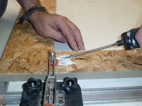

We place the pieces for each frame face down on an assembly table and put a bead of sealant in the joints. We clamp each corner firmly to the table to keep the outer faces flush and to prevent the pieces from moving while we drive the screws.
The screws themselves are designed specifically for pocket-screw joinery; they have washer heads and self-tapping threads to minimize splitting and to draw the pieces together. We use fine-thread screws with dense materials like hardwood, and coarse-thread screws with softer woods and most engineered materials used for trim. (For more about fastening PVC, see “Fastening and Finishing PVC Trim,” 09/14.)
We drive the screws using a long square-head driver bit. We’ve found that a cordless drill with clutch settings is the best tool for driving the screws; impact drivers can strip the threads out of the wood or overdrive the screws. We use corrosion-resistant screws for all exterior applications.

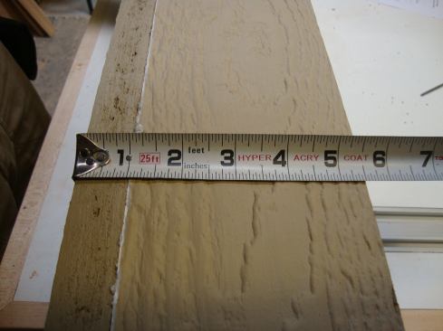

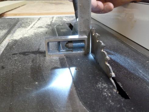

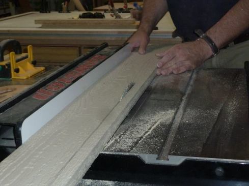

The most common method for building outside corners is a butt assembly, where the two corner boards are fastened to each other along one edge to form a right angle. To make the corners the same dimension on both sides, we first set the blade at a slight angle (2 or 3 degrees) to create a tighter-fitting joint; and then we rip down—by the thickness of the material we’re using—the board that will be less visible. For example, to make 5/4 by 5 1/2-inch corners, we rip the abutting piece to a width of 4 1/2 inches. When the corner is assembled and installed, it will read the same on both sides of the building.

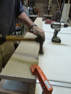

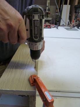

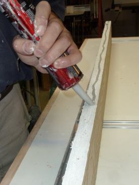

Again, we seal all cut edges with primer before assembling the pieces. Then we run a bead of sealant along the long edge of the ripped piece and bring the two sides together, clamping them as needed. We drill holes for 8d stainless steel box nails, which we then drive by hand. We avoid pneumatic nailers when fastening corners; the dense, engineered material that we use can cause gun-driven nails to drift—and often to exit through the face of the trim.
