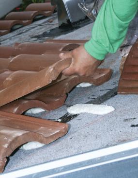

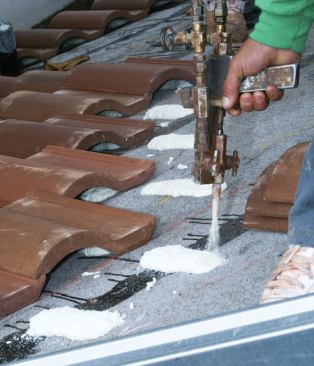

With the hot mopping done, the roof is weatherproof; it’s time to install tile. Our supplier stocks the roof, distributing the tiles to spread out the weight.

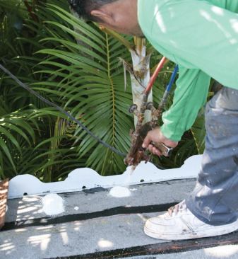

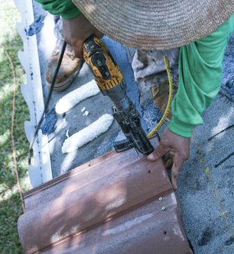

At roof edges, code requires two screws per tile. In the field, we’re allowed to use either screws or an adhesive foam. Our preference is to use both adhesive and screws at the edge but adhesive alone in the field. Testing has shown that the adhesive holds better than screws in a high-wind situation; and after doing all that work to apply the underlayment, we don’t like putting a lot of screw holes in it.

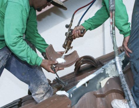

We use a two-part foam from Polyfoam (www.polyfoam.cc). Our crew are certified installers; they’ve been trained to calibrate the applicator guns, because the foam won’t perform properly if it’s not mixed in the right proportions.

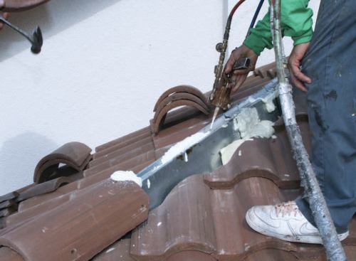

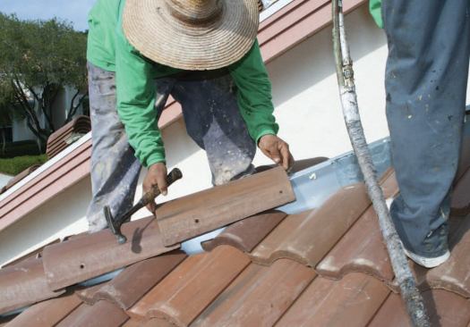

Hips and ridges require special treatment under the new codes. Research done after several severe storms showed that hip tiles were likely to get pulled loose and fly off the roof. So now, hips and ridges have to be reinforced with a metal channel – basically an upside-down “U” with flanges on the bottom. We nail the flanges to the roof deck with ring-shank nails and glue the tiles on top with the foam. Ridges are installed the same way.
