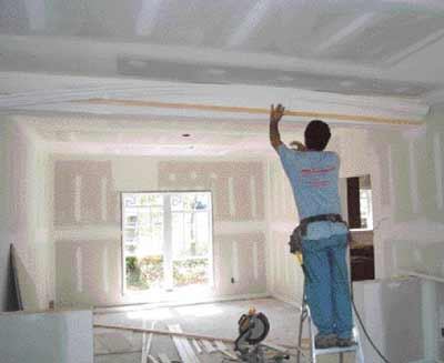

All the termination points of specialty trim such as crown, chair rail, wainscot, and so forth are next marked on the drywall in the appropriate rooms. Although we specialize in tract housing, a number of builders we work with are now offering semicustom homes, so marking out the specialty trim accurately is crucial.

Stocking the site with the complete trim package and marking door swings and special trim locations ahead of time (top) allow AMK's carpenters to do what they do best — work competently and efficiently. A two-part carbon form (bottom) records missing items before they get to be a big problem.
