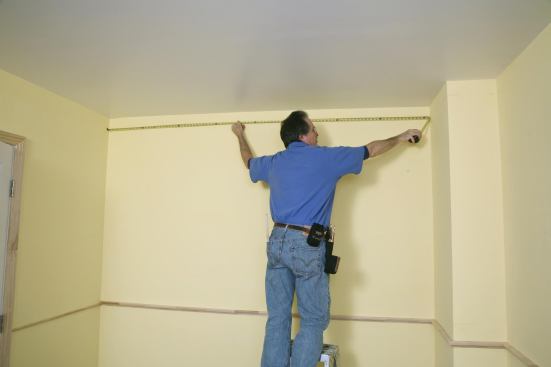

Better Measuring

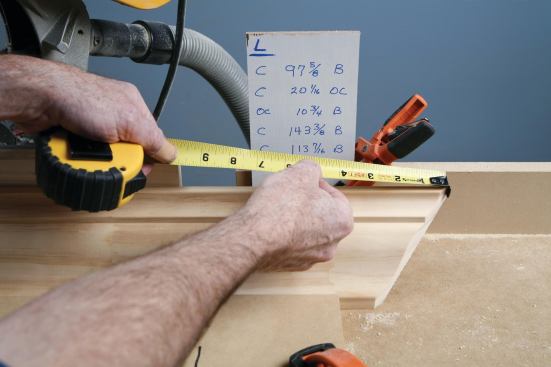

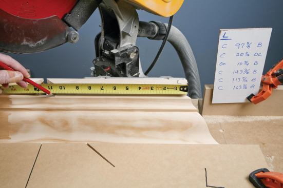

First, don’t even try to remember measurements for crown molding; it’s too confusing. To make my cut list, I start on a long wall and take down measurements in the same order that I’ll install the lengths of crown. Starting installation with a long piece makes it easier to snap the last piece into the corner, as you’ll see later.
I measure across the wall at the bottom of the crown, not up near the ceiling where the drywall compound is likely to bulge the surface. While a tape works fine for shorter distances, it’s much faster to use a laser measure for long walls — you only have to move the stepladder once.
I use consistent symbols on the cut list: a V or check mark for inside corners, OC for outside corners, C for cope, B for butt. The measurement itself is always in the middle, the left-hand cut is on the left side of the measurement, and the right-hand cut is on the right.

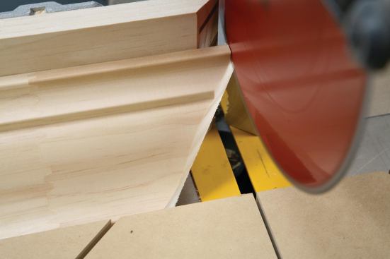

Control the Cut

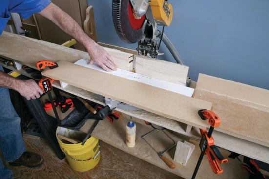

The fastest way to cut crown is in an upright but upside-down position. That way, there’s no need to adjust the bevel setting; you just have to swing the table to change the miter angle.
Burn this rule in your mind: The base of your saw is the ceiling. Repeat that every time you load a new piece of crown onto your saw. And remember, when you position the crown, don’t just roll it over on its back, but twirl it like a whirlybird blade so that the left end is on your right side and the right end is on your left side.

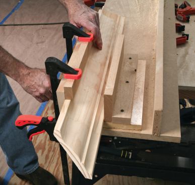

Because crown molding has no back, it’s difficult to hold it against the fence at the same angle for every cut — though we’ve all tried. The problem is that you absolutely have to hold it at exactly the same angle: If the piece slides up or down the fence by even 1/32 inch, your miters will be way off and you’ll waste time fussing with the joint.
The best way to secure crown at your saw is with a continuous crown stop. I use a piece of 1×6 and clamp it to the wings on my miter-saw stand. The stop must be installed perfectly parallel to the fence. To make that easier, I rip a gauge block. I hold a small piece of crown in position against the fence and measure how far the crown projects at the base — that’s the ceiling projection. I rip the crown gauge to that width, then use it to position the 1×6 stop. Once the stop is secured, I mark a big R on the left side and a big L on the right side, just to remind myself that the ends are reversed in cutting position.

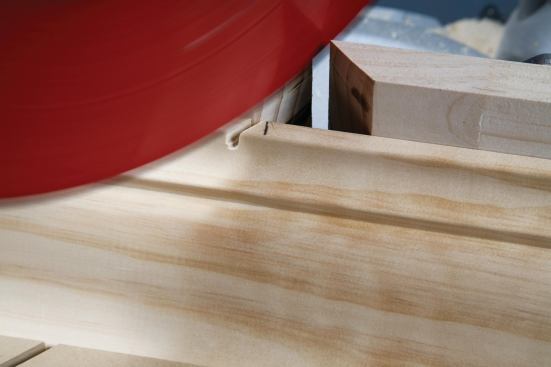

Ever since I stopped removing the guards from my miter saws, I’ve been using the “creep method” to make cuts. Besides being safer, it’s faster and more accurate than eyeballing down the blade.
I start by making a shallow cut just wide of the mark, and finish by making a cut that splits the pencil line in half — every time. To do this, I firmly place my hand — usually my left hand, with my fingers butted tightly against the fence — so it won’t move. Then I use my thumb as a micro fine-adjustment tool to slowly creep the measurement mark up to the blade.

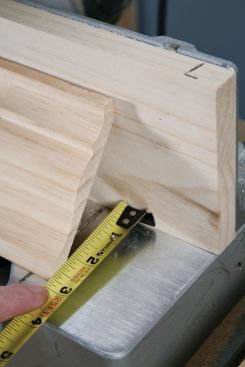

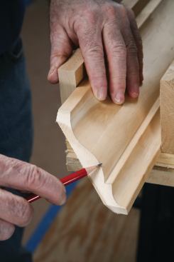

For coped corners, I first cut the 45-degree miter, then I hook the tape measure on the long point, make my mark, and cut the piece to length. Before removing the molding, I switch the saw back to 90 degrees and cut off the tip of the coped joint, so it’s a square butt cut. That makes it easier to get a tight joint.
For outside corners, I align the short point of the miter with my wooden auxiliary fence. The wood fence allows me to pull a precise measurement whether the piece is 4 inches long or 104 inches long.

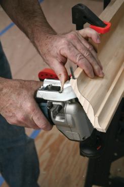

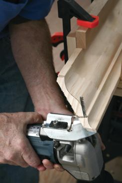

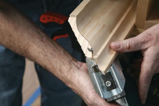

Controlled coping. Coping doesn’t have to be a nightmare. I follow the advice of David Collins, a finish carpenter and the inventor of the Coping Foot, and use a coping jig, which makes cutting copes a lot easier. With the mitered crown held snugly in an upright position, I can look straight down the miter and see exactly how much to back-cut; a pencil line highlights the cut line.
After making straight relief cuts along the fillets, I typically angle the jigsaw blade slightly to the inside, to ensure a tight joint.
By the way, since mastering the Coping Foot several years ago, I never use a coping saw — it’s just too slow. If you want to see how slow, watch this short YouTube video that illustrates the point.

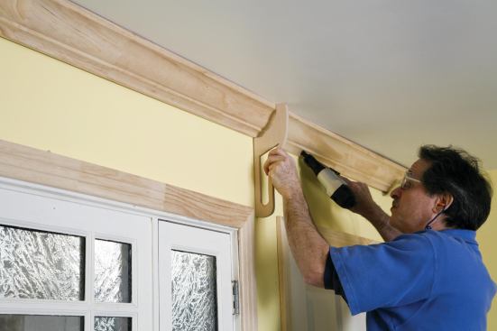

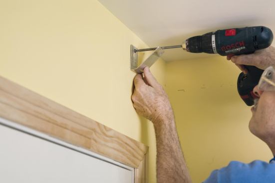

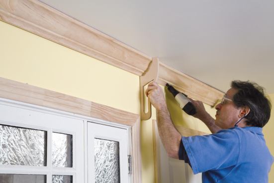

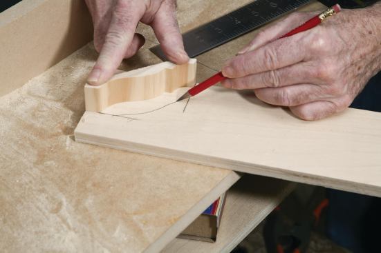

Crown holder. I used to lay out a crown installation with a small gauge block cut to match the drop of the crown. I would go around the room and use the block to mark the position of the crown’s bottom edge. The problem was that the inside corner of the wall and ceiling I was pressing the block against had the usual buildup of drywall tape and mud, so the vertical drop was inconsistent.
David Collins showed me a much better way — the crown holder. With this simple jig, you’ll be laying out the crown from right where it hits the ceiling, not back in the corner. All your reference marks on the walls will be exactly at the bottom of the crown.
Make the crown holder from a piece of thin plywood about 12 inches long. Measure across the top and mark the projection of the crown, then use a cutoff to mark the bottom. Cut clean straight kerfs at both marks, then relieve the material in the middle any way you want. Use this jig to make reference marks around the room, and to position the crown when you nail it up.

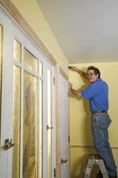

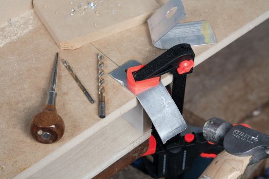

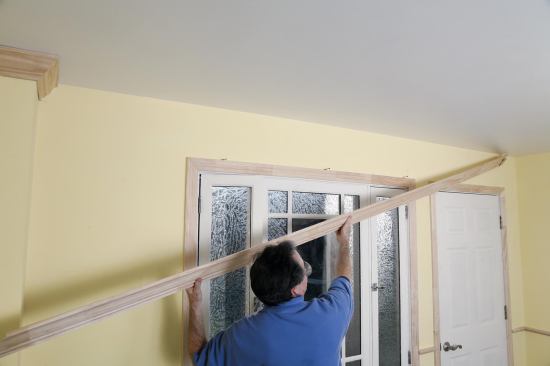

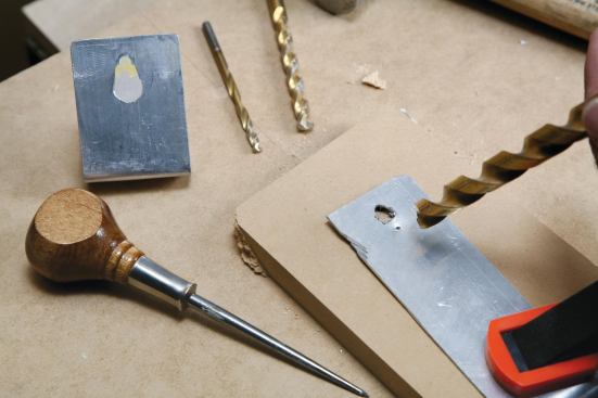

Crown hook. I don’t always have a helper, so I use a crown hook to support one end of long pieces. It couldn’t be easier to make: Drill a keyhole in a strip of sturdy sheet metal, then bend the strip of metal. Drive a small screw or tack a nail into the top plate where it won’t interfere with the crown, slip the hook on to hold the crown, and slip it off just before you fasten that end of the crown.

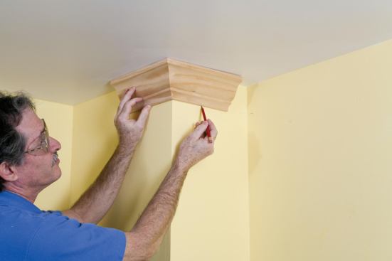

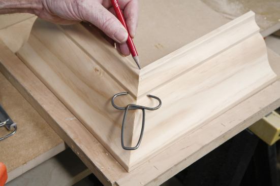

Corner mockup. Subtle elevation changes at outside corners can cause problems: If you make slight adjustments to the outside miter joint, you might throw off the cope joints in either direction. So to avoid wasted time, I often make a corner mockup, with perfect 90-degree joints, and use that to assess the corner and make my reference marks. It’s better to know ahead of time if I’m going to have to do some fudging to get tight joints.

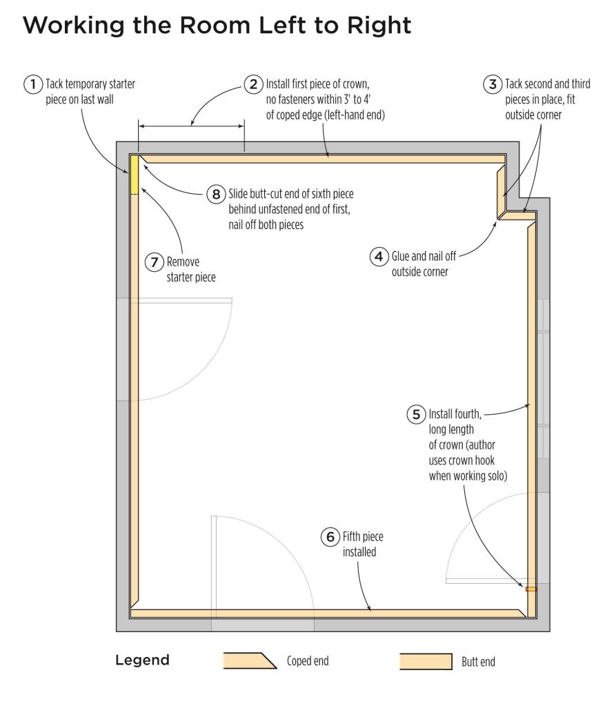

Like most of the rooms where I install crown, the room photographed for this article is mostly a straightforward rectangle, except for one outside corner bump-out; this plan works well to illustrate the approach I use whenever possible. As I already mentioned, I work the room from left to right, and I always install the first piece of crown on a long wall.

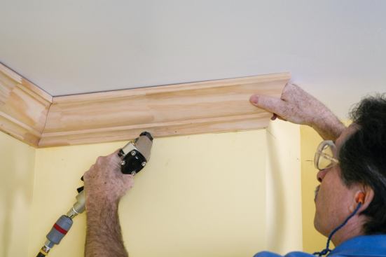

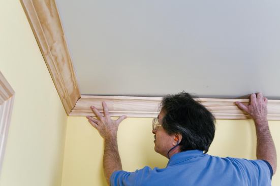

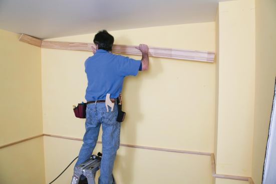

To make sure the left-hand end of the first piece is positioned perfectly, I tack a short temporary starter piece on the last wall so I have a way to fit the first cope. I use my crown gauge when tacking the starter piece to make sure it’s positioned accurately; later, when I replace the temporary starter with the final piece of crown, I want the butt cut to fit the cope like a glove.

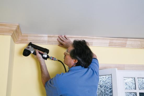

I then go to the middle of the first wall and use the crown holder to position the first piece of crown at exactly the right elevation. I nail only to the right; I don’t fire any fasteners within 3 to 4 feet of the left-hand corner. That’s because later on, I’ll need to flex that coped end away from the wall in order to slip that last butt-cut end behind it.
Outside Corners

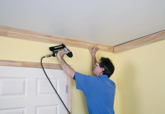

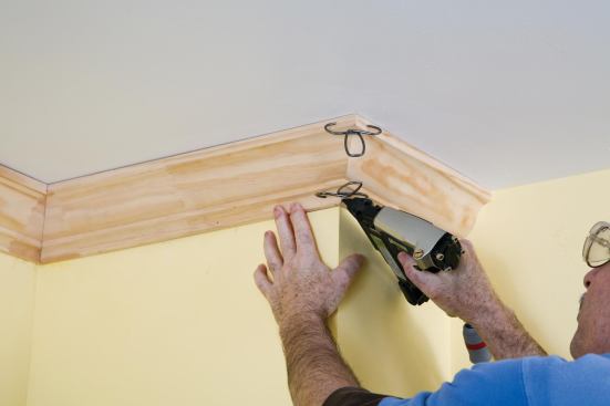

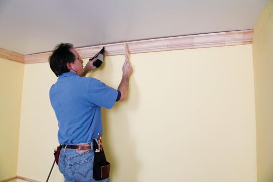

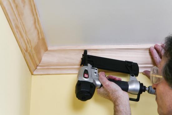

When I get to the outside corner, I tack the first piece — the inside-corner-to-outside-corner section — with an 18-gauge brad nailer. This allows me to fit the outside corner before fastening the pieces permanently; I know that I may have to trim the outside corner a hair, and I want to make sure I can remove the piece if necessary. To make sure I get long-lasting, tight joints, I glue outside corners, secure them temporarily with spring clamps, then fasten them with a 23-gauge pin nailer.
Next Long Wall

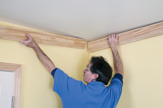

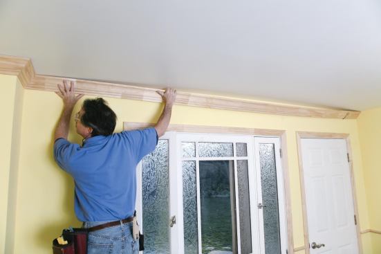

On the next section I use the crown hook. Notice that I’ve cut the piece a little long, which causes it to bow away from the wall in the middle. That’s fine; I just fit and fasten the corners first, then press the middle section to the wall when I nail it — which also helps tighten up the corners.
Occasionally, by the time I get to the butt-cut end, the crown isn’t sitting on the wall at the correct spring angle. I use a small pry bar and tap the crown to coax it into the proper position, ensuring that the following coped end will fit snugly.

When I reach the last wall, I remove the starter piece and pull the left-hand end of the first piece of crown away from the wall. I then slide the butt-cut end of the last piece of crown in behind the first piece. If the last piece is fairly long, I nail it off toward the left-hand end or in the center of the wall; if it’s short enough, I support the entire length in my left hand while I tuck it behind the first piece. I nail the last piece off, then finish up back at the first corner, in this case nailing first the top and then the bottom.
Getting a tight fit often depends on the nailing sequence. Sometimes I nail the ceiling first, then push the bottom of the crown tight to the wall before fastening it. Sometimes I do the opposite. If you haven’t installed crown before, you’ll know exactly what I mean the first time you try it.
Some rooms require a different strategy — where pop-outs or obtuse angles must be tackled first, for example. Sometimes you run into a situation where a double-cope is the best solution. But for the most part, if you cope the first piece and keep moving to your right, you’ll have a lot more fun installing crown. Remember, if a piece is a little too long, always cut a hair off the butt side. If the piece is a little too short — shame on you! Always cut them a little long!
