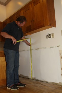

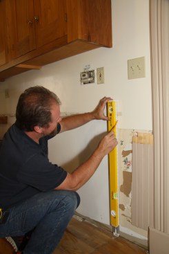

Carpenter Tim Donbeck starts by marking a plumb line on the wall where he’ll have a cabinet face frame or, in this case, an end panel.

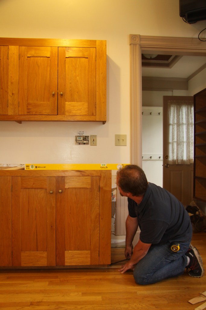

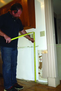

Next, he sets a laser level at final countertop height, accounting for appliances like dishwashers or stoves.

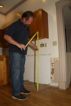

He checks the floor for high and low spots, as well as humps or dips along the cabinet run.
He also checks for the same issues along the front plane of the cabinet run to get a sense of how much he’ll need to shim and what will happen to the toekick height once it’s scribed to the floor.

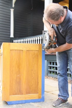

The owner wanted us to relocate a single large base cabinet in what will become a utility room, making this is a good place to illustrate some of our basic scribing techniques. Some may think them a little crude—but I can assure you that they are both efficient and effective for a skilled craftsman; doing good work doesn’t have to be elaborate or sexy. Most of the time, only a small block of wood (the fat part of a shim works well) and either a circular saw or a belt sander are all that we need. I’m sure some hipster “maker” could produce a titanium alternative, but it’s not needed. For long, straight tapers on end panels or face-frame stiles where the finished edge won’t be seen (wainscot will cover it on this job), we use a circular saw.
When the base will sit on a finished floor, especially if the floor is in an older home, we’ve found that a belt sander can’t be beat for wasting away material on the cabinet bottom. We like that it provides a good amount of control and can follow even slight variations (like subtle waves) in the floor. The sander also removes a significant amount of material quickly, so it’s fast. The circular saw and belt sander were the perfect tools for this job; we could maintain high quality and accuracy but still work quickly without a lot of fuss.

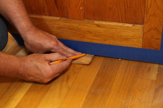

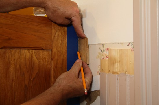

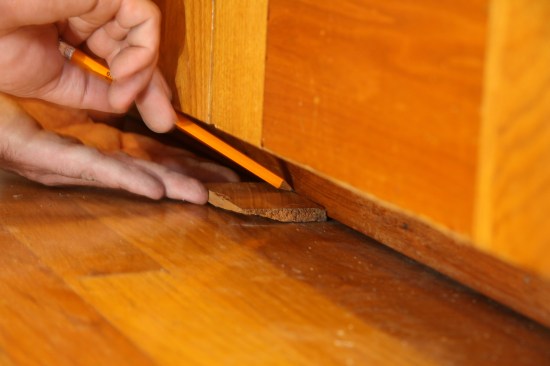

Next, he scribes to fit the contour of the floor and the wall, using a pencil and a scrap of wood that matches in thickness the widest gap he shimmed (he didn’t have dividers on hand for this job).
He does the same thing along the end panel’s stile and rails as well. He likes to put tape on the surface of darker woods to better see his mark and also to help prevent tear-out.

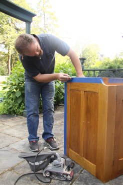

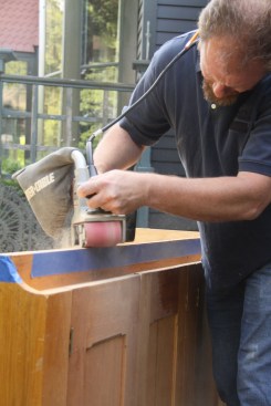

Once everything is marked, Donbeck removes material from the base, using a belt sander. Here, to ensure a crisp line at the floor and wall, he maneuvers the sander so he bevels slightly away from the front plane.
On finished panels like this bottom rail, he cuts the tape and the scribe line to prevent tear-out.

For longer straight runs where the line won’t be shown (this one will be covered by wainscot), he uses a circular saw outfitted with a finish blade. When this line will be visible, he uses a power plane. On high-end cabinets, he almost exclusively uses hand tools, and even scrapers. Reading the grain of the wood is important. When grain changes direction along the length of one board, as it can in many hardwoods, power planers and even hand planes can blow out the grain in an instant, so a scraper is often necessary. The process is more time consuming, but the result is what’s most important. The author typically knows the level of cabinet when he bids the job, so he’s sure to account for the extra time these types of details will take.
