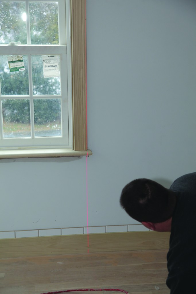

A laser indicated how the edge of the window trim would line up with the grooves on the wainscot.

One of the keys to installing wainscot easily and having it look great is laying out the material so that the grooves don’t line up directly with vertical elements such as window casings and electrical outlets. I used the 2-inch strips in combination with a laser to fine-tune the layout. First, I lined up the laser roughly on the edge of the window trim and noted where it fell on the strip. I checked both sides of the window and made sure that the edges landed well between the grooves. With the strips running all the way across the wall, I also checked the layout at the other window.
Next, I moved to the electrical outlet in the middle of the wall and checked the layout there. On this wall, the layout for the outlet landed just to the side of the groove, so I slid the strips down an inch or so and rechecked the layout at the windows to make sure it was still acceptable. When I was happy with the layout, I marked the end of the strip nearest the outlet. That mark would align the first piece of wainscot.

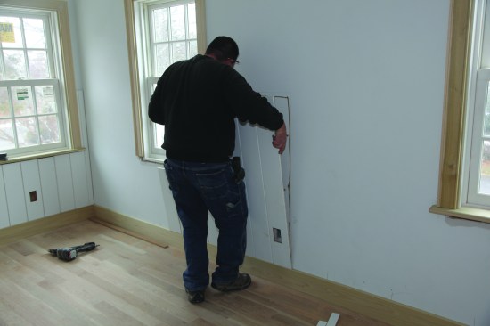

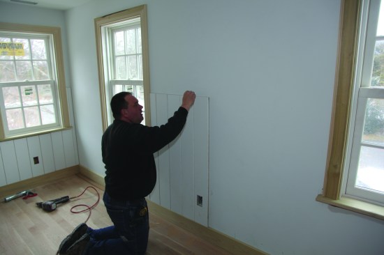

I set the starter sheet of wainscot on the baseboard and lined it up with my mark. I then marked the edges of the window trim—along with both the side casing and the bottom of the apron. For the outlet, I slid the piece down the baseboard and marked the top and bottom of the electrical box. Then I measured from my layout mark to both sides of the box and transferred the measurements to the wainscot sheet. This was one of the few times I used a measuring tape during the installation.
I made the cutout for the window by making passes in two directions on a table saw and retracting the blade when I’d reached the intersection point. For the outlet, I squared my marks and cut out the rectangle for the box with a jigsaw. With the cuts made, I dry-fit the piece and drew a pencil line along the perimeter. I spread construction adhesive just inside the perimeter marks and then ran two or three beads across the width of the piece. Then it was just a matter of pressing the piece in place and driving perimeter nails at each of the stud locations.
After making cutouts for the window and the outlet, the author dry-fit the piece and drew a pencil line on the wall along the perimeter.
The piece was secured to the wall with construction adhesive and nails.

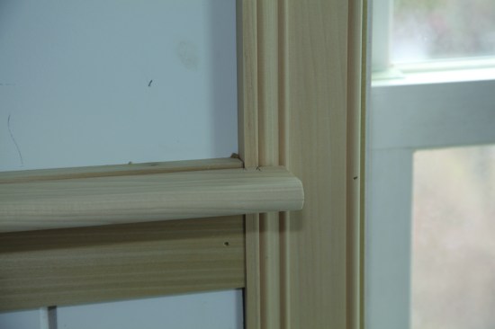

The bullnose cap came next. We’d ordered 5/4 bullnose stock for this project, but ripped it down to 2 1/4 inches so that it stepped nicely to the cove molding once everything was installed. Cap molding never looks right if it just butts into the casing, so I lap the ends a little. The end detail depends on the type of casing; on this project, the casing started with a flat return about 1/2 inch wide. I made the return on the cap so that it ended on the flat part of the casing just before the rest of the profile began. Then I routed a bullnose on the return with a 1/2-inch round-over bit.

The author left the cap a little long and set it on the rail. He marked the length, as well as where the cap returned to the wall.
For the best look, the author lets the long point of the cove end at the edge of the casing.
