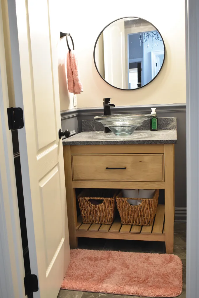

Design. My biggest concern was getting the height right, because the vanity would feature a vessel sink that would sit on a stone countertop. So I waited until we had the sink on the jobsite before deciding on a 33-inch vanity height and starting to build the vanity.
The design includes four exposed square posts, each with a slight taper at the bottom, and an exposed shelf made of slats about 5 inches up from the bottom of the vanity. There’s a single, wide drawer front with matching side insets between the posts at the top. All of the parts that are visible are made from poplar.

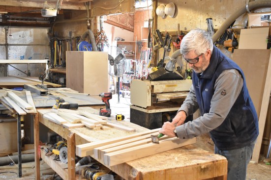

Post construction. Everything fits between the posts, so I glued them up first, starting with one oversized glue-up that I ripped into oversized blanks. That gave me room to straighten the legs, plane them to their final dimension (2×2 inches in this case), and cut off any snipes at the end.

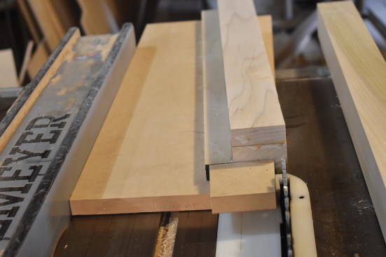

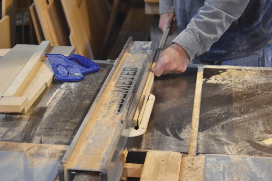

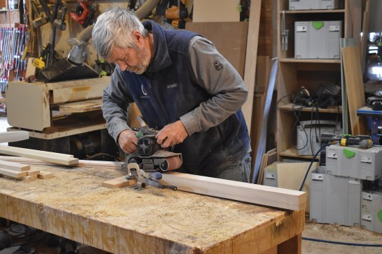

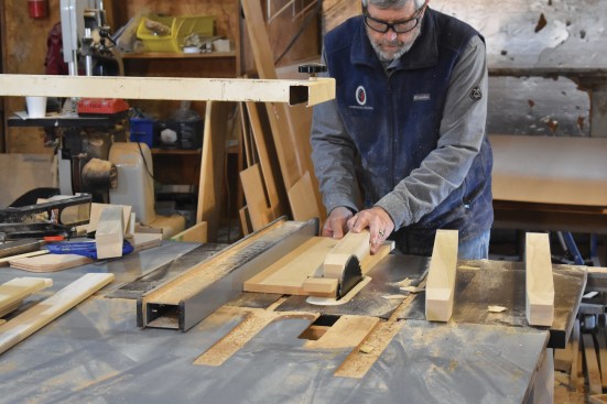

I made a simple sled jig for the table saw to cut the bottom leg tapers, setting it up to cut from 3/8 inch to zero over 3 inches. To cut safely, I made the jig extra long to keep my fingers away from the blade and turned the saw off after each cut, waiting for the blade to stop before resetting for the next cut. For smooth cuts, I use a Tenryu combo blade on my table saw, but I still had to touch up each cut with a belt sander.
After gluing up poplar blanks for the vanity’s corner posts, the author scraped off dried glue, then planed the blanks to finish size.
The posts have tapered legs, which the author cut with the help of a simple jig to allow for uniform rips and to keep his fingers away from the blade.
The jig consists of a ripping screwed at an angle to an MDF block, with a stop block to align the workpiece.
After cutting the tapers in the 2×2 posts, the author used a belt sander to smooth away kerf marks.

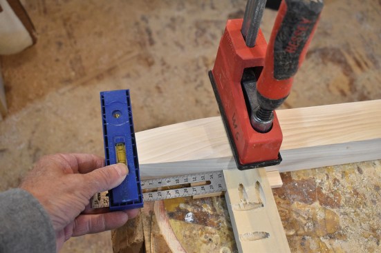

The author used a Kreg Multi-Mark layout tool and blocks and clamps to position the rails accurately when fastening them to the posts.
The rails are joined to the posts with pocket screws. The pocket holes that are visible along the bottom rail will be used when the slats that make up the bottom shelf are installed.
Pocket screws make fast, strong joints, but keeping the correct alignment can be challenging. I used clamps and spacer blocks to maintain accuracy and a Kreg Multi-Mark measuring and marking tool to pinpoint the locations of the bottom rails.

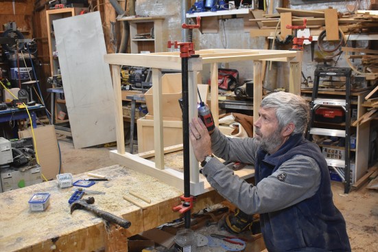

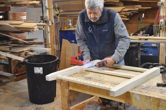

I started out by making the front and back panels, screwing the long rails between the posts. Then I screwed the shorter side rails to the back panel. Working off the top of a workbench, I used pipe clamps to hold the front section in place when I installed the last pocket screws.
After assembling the front and back panels, the author screwed the three shorter side rails to the back panel. Then he drew the assembly together with clamps as he installed the front panel.

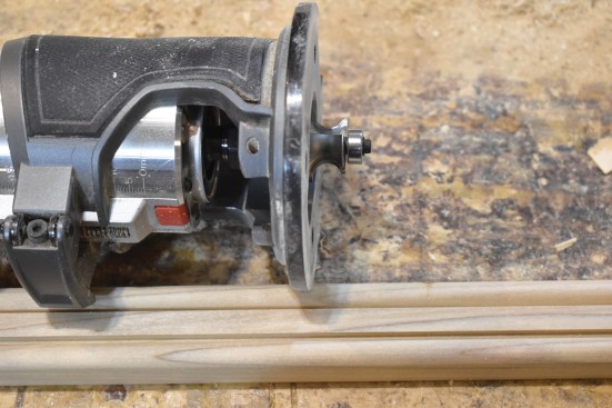

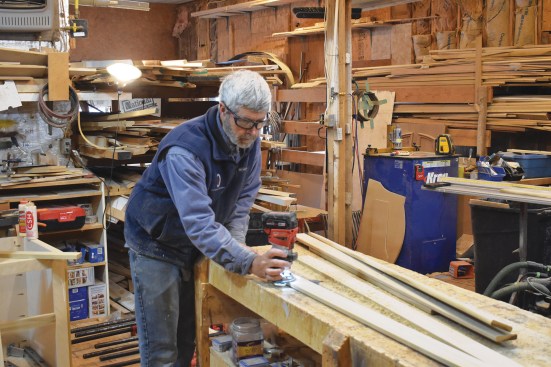

The author milled the 2-inch wide slats that make up the bottom shelf down from 3/4 inch to 5/8 inch thick, then eased their edges with a round-over bit mounted in a trim router.
Slat shelf. Like the rails, I ran the 2-inch-wide bottom shelf slats on edge through the planer to get rid of saw kerfs. I also ran them through the planer to thin them to 5/8 inch thick, then rounded over the corners. I suppose the slats could be left at 3/4 inch thick, but I think the thinner, 5/8-inch-thick slats look a lot better.

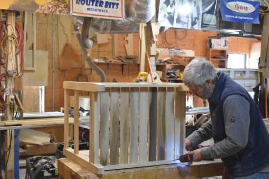

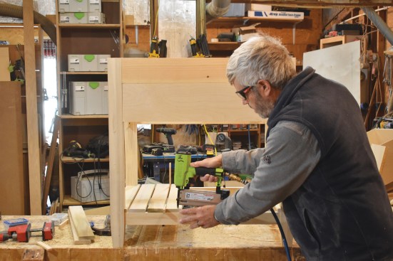

After cutting all the slats to length, I did a test layout to get the spacing right, then tacked each one in place with a 21-gauge pin. I notched the first one around the legs, then went from left to right; next time, though, I think it will be easier to start in the middle and work toward each end. The pins were strong enough to keep the slats in place until I added the pocket screws from the bottom.
To make sure the shelf slats were properly located and evenly spaced, the author first tacked them to the bottom rails.
Then he flipped the assembly on its side and secured the slats with pocket screws driven up through the rails.

I really enjoyed building the cabinet. It didn’t take a lot of material, and I probably could have built two in close to the same time as it took to build one, but there is only so much storage room in my shop. Besides that, I wouldn’t want to mess up the chance to spend another day working there.
