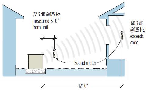

A. A "quiet" condenser that measures 72.3 dB at 3 feet will measure about 60 dB at 12 feet, according to the inverse square rule (doubling the distance yields a reduction of about 6 dB).

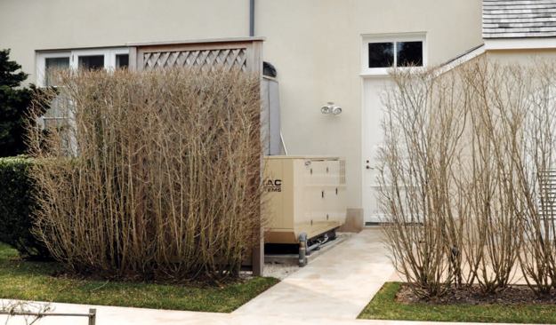

Soundproofing a pool pump is relatively easy: We mount it on vibration isolators to block structural noise and build a complete enclosure around it to block airborne noise. But soundproofing a generator or AC condenser is trickier. Since these units require airflow, you can’t enclose them completely, so you need to equip the enclosure with sophisticated silencers and baffles, an engineered solution we typically use only in commercial construction.

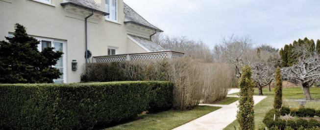

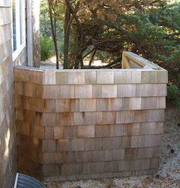

In residential construction, we can usually get good results by putting an acoustically insulated barrier between the noisy unit and the neighbors, as we did for the two projects shown in this article. One of those jobs involved bringing a standby generator into compliance with local noise ordinances; the other was precipitated by a dispute between neighbors over a noisy AC condenser. We use the same general techniques to muffle other types of outdoor equipment as well. Keep in mind, though, that whenever laws or codes are involved, you may need to consult with an acoustic engineer to get accurate measurements and effective results.

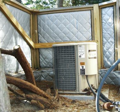

Airborne noise. A conventionally framed and plywood-sheathed enclosure or barrier will block a certain amount of airborne noise. But with a sound transmission class (STC) rating of only about 21, 1„2-inch plywood generally won’t eliminate all noise, and in fact could add to the problem by reflecting and amplifying certain frequencies. So we add acoustic materials to the barrier that will both reduce and absorb sound.

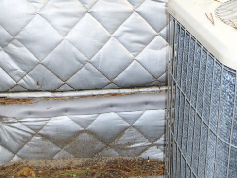

The acoustic blanket we use is made with a fiberglass absorber bonded to mass-loaded vinyl, which is a limp and heavy material that looks a little like sheet vinyl (see slideshow). The blanket has an STC rating of 32 and a noise reduction coefficient (NRC) of .85 (for an explanation of these and other terms, see the glossary on the facing page). Lining the barrier with this material can provide as much as 15 dB of additional noise reduction, a decrease in sound energy of more than 90 percent. That means that a condenser shielded by this barrier will sound less than half as loud as a freestanding unit.
