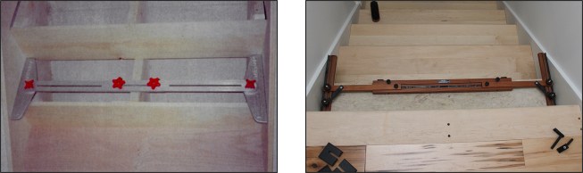

Risers can be ripped to a width equal to the net rise minus the tread thickness. For measuring and marking risers and other pieces that meet the wall skirt on one end and the newel post on the other end, I use my handmade stair gauge (Figure 7). Alternatively, you can use a scribe. Cut the risers with a 45-degree bevel to match the face skirt. Install them by spacing off of the sub-tread with tread scraps, gluing the miter joints, and nailing off from the bottom working upwards.
Figure 7: A stair gauge helps to mark cuts for both risers and treads. You can make a stair gauge out of two pieces of plywood, cut off at a bevel, screwed to a stick cut to the right length. You just push them into place and screw them together with the stick. Or you can make up a permanent adjustable gauge by routing an adjustment slot and attaching the bevel pieces with adjustable wing nuts. You can also buy a gauge like the one shown here. [Editor's note: The gauge tool on left has been discontinued since the article’s original publication; the adjustable gauge on the right, the “Stair Wizard” from DNB Tools, is currently available and sells for about $200 on Amazon.]

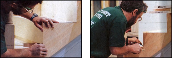

After the risers are in place, there is one quick task to take care of — notching the face skirt where the treads slide into place under the risers (Figure 8).
Figure 8: The author spaces the finish risers off the sub-treads before gluing the miter joint and nailing the riser off (left). He then notches the face skirt to make way for the treads later on (right). The depth of the notches equals the tread width minus the net run minus the overhang. For example, if the treads are 11-1/2 inches, and the net run is 10 inches, and there’s a 1-1/8 overhang, the face skirt needs to be notched 3/8 inch.

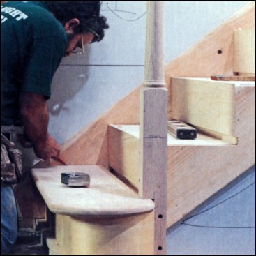

Treads. Manufactured treads are reversible because they are sanded on both sides. After scribing each tread to fit (Figure 9), I put construction adhesive on the underside of each of the treads and slide them underneath the already installed risers.
If the fit is tight, try using a 5-lb. non-marring rubber hammer to persuade them into place. I use my white rubber Porta-Nailer mallet. Be sure to double-check the overhang. The risers will pin the treads to the frame on the backside, but the treads still have to be nailed off along the front to ensure a good glue bond. To finish out the treads, I glue, and brad scotia molding under the tread nosing and nosing return.
Figure 9: To install treads, the author first cuts them approximately to length — to within scribing range. He then puts them each in place temporarily, making sure the overhang along the front is even. After setting a scribe to the distance between the nosing return and the face skirt, he marks that dimension against the wall skirt. On steps with newel posts, he also has to scribe around the newel post.

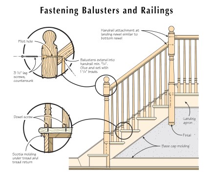

Most codes require a maximum 4-inch space between balusters (Figure 10, “Fastening Balusters and Railings”). Remember that if you’re using balusters that have been turned on a lathe, the maximum spacing rule applies to the thinnest portion along the profile. If you have a turned baluster with a 1-1/4-inch base on a 10-inch tread, you actually end up needing three balusters per tread. With 1-3/4-inch balusters on 9-1/2-inch treads, you might only need two per tread.
Click to enlarge
Figure 10: After the baluster bottoms are tightened into place using dowel screws, the author installs the handrail over the pin-tops and runs lag screws through the newels to fasten the balustrade system together.

For attaching balusters to the treads, all of the stair manufacturers provide a type of dowel screw (a screw that has a lag-type thread on both ends). When screwed into the bottom of a tread, 1/4 x 2-1/4-inch dowel screws really hold a baluster down. To use dowel screws, you have to predrill holes in both the treads and balusters. Some manufacturers predrill the balusters.
To install the balusters, remove the handrail and use the dowel screws to attach the bottoms, making sure the squares line up. Using dowel screws with square-top balusters is harder because they need to tighten to one exact orientation. But with some fiddling, it’s still the best possible option.
Setting the handrail. For pin-top balusters, place glue on the baluster tops and handrail ends. Set the handrail onto the balusters and permanently fasten it into position. Use 1-1/4-inch brads to hold the balusters in position. For square-top balusters, fasten the handrail into position and then plumb, glue, and nail each baluster to the underside of the rail, taking care to center the baluster on the rail. When post-to-post newels are turned on the lathe, blocks are left at the bottom for attaching the newel to the carriage and at the top where the handrails attach. Rails are typically attached to newel posts one inch below the edge of the top blocks.
