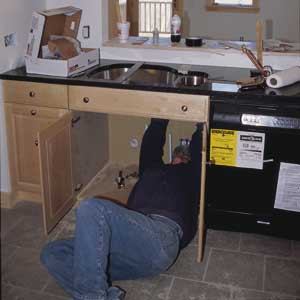

Installing an undermount sink requires careful planning and coordination between subcontractors
The demand for undermount sinks is growing. Even if you haven’t had to install one yet, it is probably only a matter of time before a customer requests one. Because undermount sinks – also called undercounter sinks – are generally used only with stone or solid-surface countertops, they tend to be found in high-end kitchens. This raises the stakes for the builder, who is likely to face a more demanding client, and will need to coordinate the work between several subcontractors. Customers who like the elegant appearance of undermounts are willing to pay an up-charge for them – not only for the countertop, but also for the cost of the sink and the additional installation time. Because sink manufacturers know that undermounts are used only with high-end countertops, they see no reason to market budget-priced undermount sinks. In general, the price of a double-bowl stainless steel undermount sink starts at $400, and heads north from there. For less-expensive laminate countertops, a drop-in sink – also called a self-rimming sink – is usually required, because the sink cutout exposes the vulnerable particleboard substrate. However, Counter-Seal is now marketing a system for installing undermount sinks with laminate countertops (see sidebar, ).
