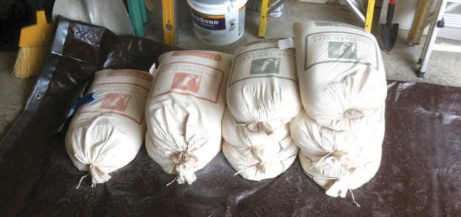

Our most recent challenge was to plaster the walls and ceiling of an existing master bedroom surfaced with a combination of old and new drywall. The old drywall was textured and painted, and the new drywall was bare panels. The job called for a base coat of Loma plaster and a top coat of Porcelina plaster, both of which come in 50-pound sacks. On the walls, we blended both coats with a color pigment called Rio Grande Pecan. The ceiling is uncolored.

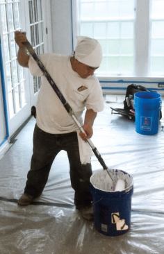

Base coat. At the end of the day, we used a paddle and two 5-gallon buckets to mix the base coat for the walls and the ceiling. The mix needs to sit for at least 30 minutes. Since we don’t use extra additives, our mixed plasters last almost indefinitely in sealed containers. We capped the buckets and left them overnight so we could start troweling first thing in the morning.

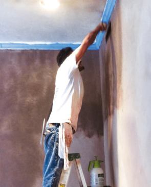

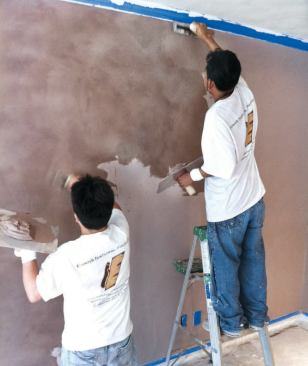

The next day, we applied the uncolored base coat to the ceiling and the colored base coat to the walls – both to about the thickness of a credit card – using 240-millimeter flexible stainless-steel rectangular trowels. I buy these Japanese tools from American Clay for $36 apiece, and they’re awesome; they have the perfect shape and flexibility for applying both the base and top coats. American Clay sells several other Japanese steel and Lexan-plastic trowels that we also can’t live without.

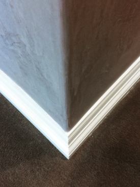

Next, using the same trowel and a damp grouting sponge, I carefully bullnosed the outside corner. When the corner became “leather hard,” I compressed it lightly with the sponge. Not everyone does this, but I like to because it makes the vulnerable corners harder.

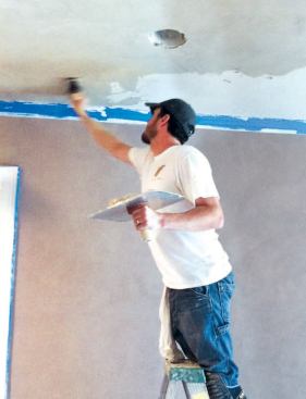

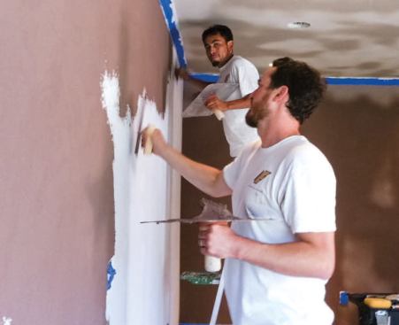

Top coat. We applied the Porcelina top coat to the ceiling the next day and to the walls two days later, again to credit-card thickness. I applied a second top coat over the outside corner, again working the plaster meticulously with trowel and sponge to maintain the bullnose. Sometimes you need to mist the base coat with water before applying the top coat to prevent premature drying, but we were working in high humidity and had to use a fan to speed the drying process.

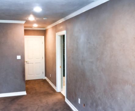

When it was dry we had a smooth surface, with the color running all the way through to the substrate so minor bumps and scrapes wouldn’t remove it.

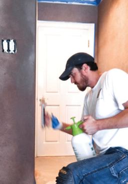

Finish. The next day was the fun part: compressing and burnishing the top coat to create a durable, beautiful finish. The proper technique varies depending on the desired results; for this job, we used spray bottles to wet the surfaces with water before working the plaster in firm, wide strokes with 300-millimeter rigid stainless-steel rectangular trowels. The process created a rippled texture and added dashes of gray to the purplish-brown walls and white ceiling. Since sweet corners are one of the hallmarks of a good applicator, I also fine-tuned the outside corner with a 240-millimeter Lexan-plastic pointed trowel and a spray bottle.

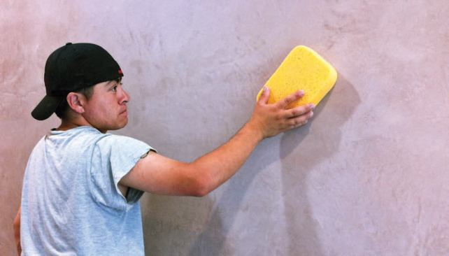

When the plaster dried, we ran a razor blade along the edges of the trim and removed the painter’s tape. Before pulling the 6-mil poly, we buffed the entire plaster surface with dry grouting sponges. You won’t find that extra step in American Clay’s instructions, but it removes any water marks left from troweling, wipes residual sand and fine dust from the surface, and brings out the sheen.
Touch-ups. The job took three of us four and a half days to complete. In the future, the homeowners will be able to remove most marks with a dry sponge. I always leave a touch-up kit, however, so I can easily come back and do repairs if necessary. If they ever want to change the color or texture, we can recoat.
