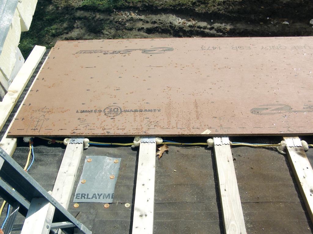

“Skippers” refers to skipped sheathing — the gapped roofing boards you see when you look at the underside of a cedar roof, which, as you say, allow the roof to dry. You can’t do much better than that on a small building like a garden shed. By “verticals,” David Mills means the 2-bys that are run up the slope over the rafters and sheathing of an existing roof to provide soffit-to-ridge ventilation channels; these can be crossed by either horizontal skipped sheathing or another layer of sheathing. They might be used during a reroof for a built-up roof assembly in an insulated structure (see the photo below that David Mills kindly provided of 2×4 verticals on a double-sheathed job). — The Editor
