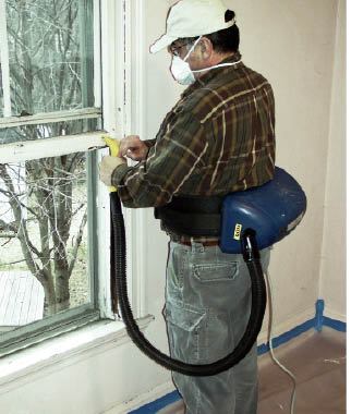

Necessary equipment. Every remodeler should have a good HEPA (high-efficiency particulate air) dust-collection system. Sanding, grinding, and power planing are specifically prohibited unless the tool has a dust-collection shroud and is connected to vacuum with a HEPA-rated filter.

A simple dust mask isn’t sufficient protection when working with lead; at minimum, you’ll need a NIOSH-rated N100 or HEPA respirator, even if the tools you’re using are connected to a HEPA vac. Disposable coveralls, shoe covers, and gloves aren’t required but can make it less likely that lead dust will be tracked home from a job.
