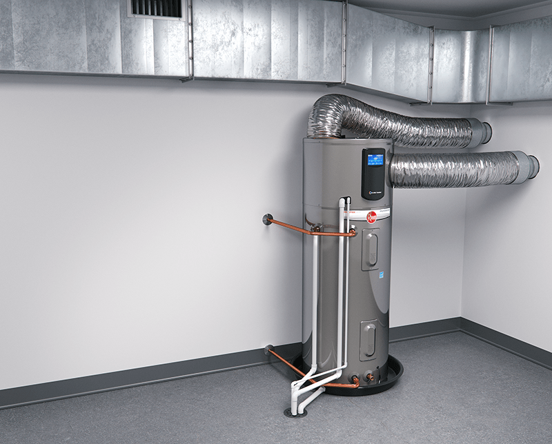

A heat pump water heater can be installed with a duct kit. Most water heater manufacturers allow just the inlet duct (if the water heater is in a small space and additional airflow is needed), or just outlet duct (to direct the cold air exhausted by the unit to the outside), or both. (Photo courtesy Rheem Manufacturing)

A heat pump water heater can be installed with ducting. Most water heater manufacturers allow just the inlet duct (if the water heater is in a small space and additional airflow is needed), or just outlet duct (to direct the cold air exhausted by the unit to the outside), or both.

It is possible to make this work by installing outlet and/or inlet ducting to the unit (this is model dependent). HPWH manufacturers often offer adapters, or “duct kits,” built specifically for this purpose. This adds an extra cost to buying the water heater, but the kit and requisite ductwork allows you to install the unit in a basement or crawlspace, or in a small, sealed closet with no minimum space requirements.
It is possible to put the HPWH in an insulated closet, using louvered doors with the size of the louver area based on the space requirements of the specific model. The louvered door will provide enough air for the unit to operate efficiently. In one example we saw, a full-louvered door lowered the space requirement from 450 cubic feet to 84 cubic feet—an 81% reduction. However this option will not prevent the unit from cooling the space outside the closet.
