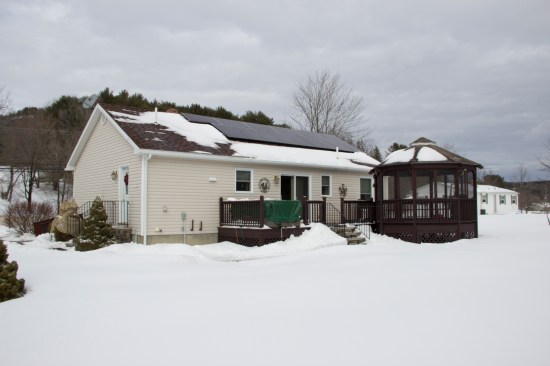

PV panels on this small house are sized to carry much of the home’s annual load, including heat and hot water.
Going solar. In the last case (where the customer wants to switch to clean energy), ReVision can offer a package of photovoltaic panels, mini-split heat pumps for house heat, and a heat-pump water heater for domestic hot water. Pairing heat pumps with PV pencils out as the solution with the lowest lifetime operating cost, especially if the long-run price of fossil fuels rises, says Bernard: “You pay for the panels, and they put out free power for 40 years.” But the practicality of that approach depends on the household’s total water needs. For high-volume hot-water users, like large families with young athletes to raise, or homes with jetted tubs, thermal water-heating panels with a fossil-fuel backup offer output that a heat-pump water heater can’t match. But the heat-pump water heater is a good fit for families who might expect to use less than 100 gallons in a morning or evening, like the retirees in the house shown above; ReVision calculated a five-year or six-year payback for these PV panels coupled to heat pumps for heat and hot water.

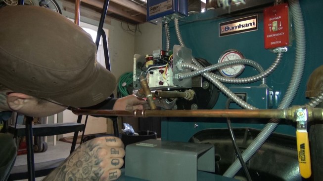

Getting off oil. Unlike most of the United States, where oil barely figures in the home-heating fuel mix, about 25% of the heating energy in the Northeast is oil. Maine is the extreme example: 64% of Maine households heat with oil. In many of those homes, a tankless coil in the oil boiler heats the domestic water. That’s a very inefficient method of heating water, not least because it requires a boiler that’s sized to provide ample heat in the dead of a Maine winter to stay hot all summer long just to keep water ready for the occasional shower or dishwashing session.
ReVision Energy master plumber Dan Leonard cuts a water line serving the existing boiler.
The job shown is a classic example of the best case for a heat-pump swap-out: The tankless coil in a boiler is being disconnected and decommissioned, allowing the boiler to run less in winter and to shut down altogether as soon as the weather moderates enough to allow the air-source heat pumps to handle the home’s full heating load. The boiler is being “unloaded” except when it’s needed to heat the home during the coldest hours of winter (the continuous-run scenario when the boiler operates at its highest efficiency)—and photovoltaics will supply the juice.

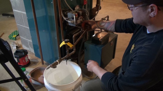

He tightens down the plate on the tankless coil so the gasket won’t leak.

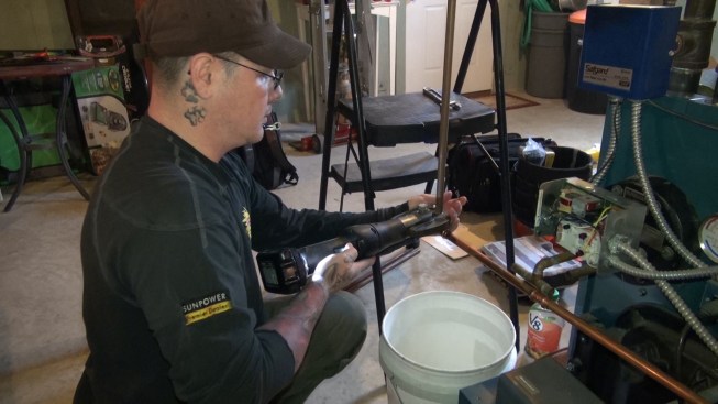

Then he patches in the water line for topping up the boiler’s hydronic loops using a solderless compression fitting.

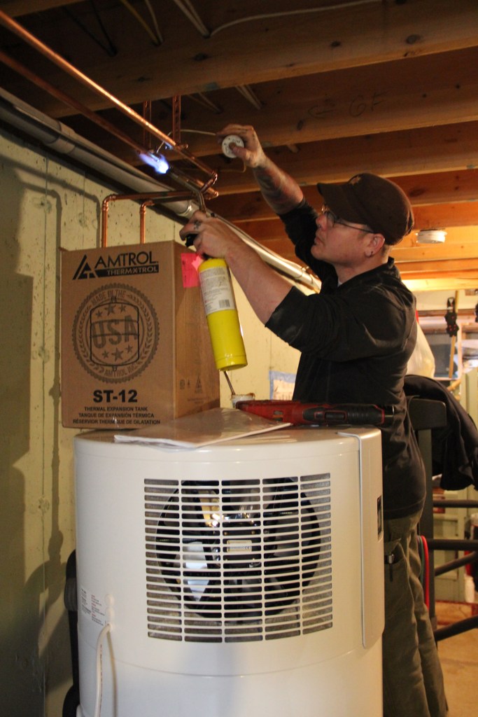

The heat-pump water heater being installed here is a top-of-the-line Stiebel Eltron Accelera “E” unit, ReVision Energy’s go-to choice. It comes with a 10-year guarantee and uses a low-voltage direct-current circuit, rather than a sacrificial anode, for corrosion protection. ReVision Energy’s Brandon Bernard speaks highly of the equipment, but he acknowledges that heat-pump water heaters have limitations and aren’t right for every situation. The units work by pulling heat out of the room air where they’re located, so they need at least 800 cubic feet of space around them—and when they’re operating, they can cool that surrounding space by as much as 5°F to 10°F. The heat-pump motors are noisy (although not as loud as a typical high-mass oil boiler). And the coils collect condensate that has to be drained somewhere—but the upside, at least for basement locations, is that the units dehumidify the space whenever they’re running.
