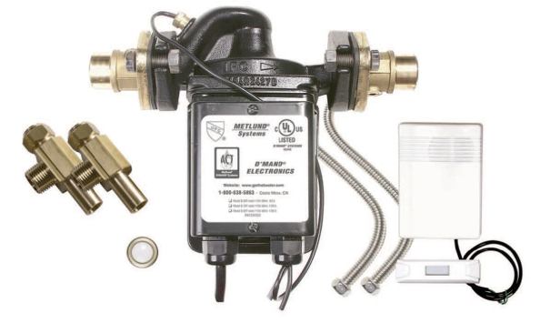

These days we primarily install on-demand hot-water systems. We like them because they deliver the hot water rapidly to all the taps on the branch, cutting way down on the amount of cold water wasted down the drain. They offer the same convenience as a whole-house system but without the energy penalty. We install both Metlund (800/638-5863, gothotwater.com) and Taco D’Mand (401/942-8000, taco-hvac.com) systems. Taco makes the circulating pump for both.
On-demand systems feature a high-head pump capable of quickly moving the slug of cold water standing in the hot-water supply pipe toward the farthest faucet on the branch, along with the fully heated water from the water heater behind it. This is in contrast to most whole-house circulation pumps, which are low-head and therefore move the water at much slower flow rates.

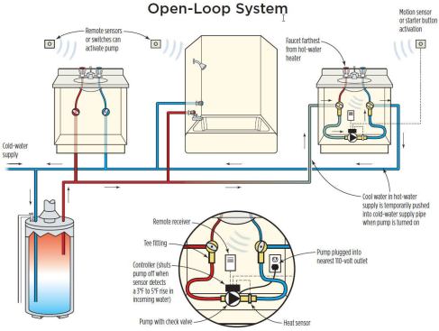

How on-demand pumps work. When the on-demand pump comes on, any cool water in the hot supply pipe is pushed into either a dedicated recirculation line toward the water heater (closed-loop configuration) or back into the cold-water supply pipe (open-loop configuration). As soon as the temperature sensor installed in the hot supply detects a 3°F to 5°F rise in the incoming water, the system’s electronic controller shuts the pump off.
Open- vs. Closed-Loop Systems

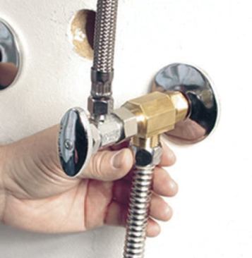

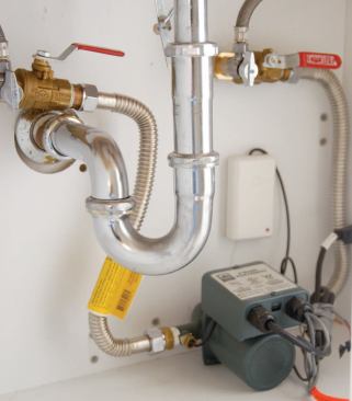

On-demand pumps are small enough to fit in a bathroom vanity cabinet or below the kitchen sink. We usually place the pump under the faucet that’s farthest from the hot-water heater, especially in a retrofit project. In a simple open-loop — or non-recirculating — installation, the pump module connects to the hot- and cold-water supplies with tee fittings located just before the angle stops. The pump can simply be plugged into the nearest 110-volt outlet. If the electrical circuit is already in place, it usually takes less than two hours to retrofit a house with on-demand hot water.

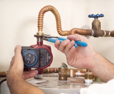

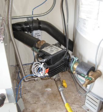

Hot water return. However, with new construction or during a large renovation, when extensive plumbing work is being done, we prefer to install a dedicated hot-water return leg from the farthest fixture on the branch line back to the water heater, creating a closed loop. This extra plumbing adds cost and isn’t absolutely necessary, but it allows us to place the on-demand pump at the water heater rather than in a bathroom, which eliminates a potentially bothersome source of vibration and noise.
The dedicated leg also eliminates the possibility that small slugs of warmed water will be pushed into the cold-water supply line, which, in our experience, can happen with certain open-loop systems. For example, we’ve found that the temperature-sensitive cartridges in the Grundfos Comfort system, an open-loop whole-house circulation system, often fail, allowing hot water to come out of the cold-water tap. With a hot-water return pipe, this can never happen.
