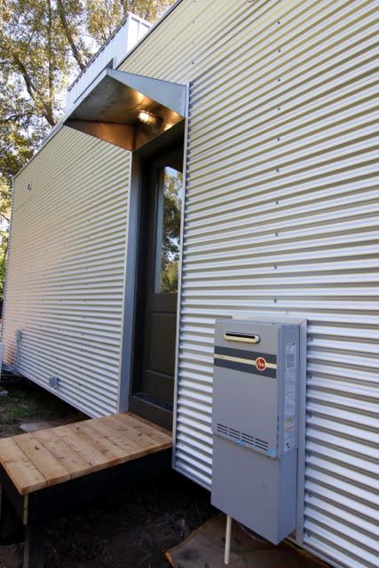

Rheem Tankless installed near the back door of this house.
Tankless water heaters are fantastic units but they do need more care & maintenance than a typical 50 gallon tank heater. Here in the Southern US, I prefer to install my tankless units outdoors. This means you won’t take space in the house and you never have to worry about venting or combustion issues. Here’s a picture of a typical install for me. I like the Rheem RTG-84XLN Exterior Gas units and here’s a picture of one I recently installed on a house in Austin.

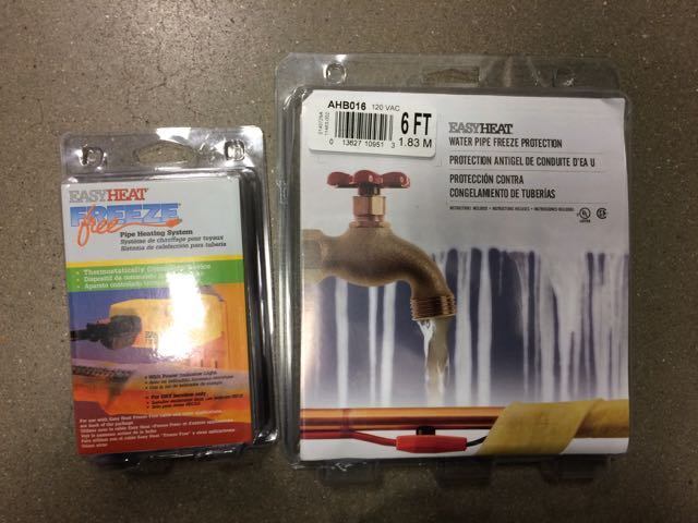

The units themselves are protected as long as the power is on because they have an electric heater inside the boiler that keeps the unit from freezing. However, the pipes to/from the unit are vulnerable to freezing. Pipe insulation only provides minimal protection for these pipes because of all the valves and bends. My recommendation is to buy a Easy Heat Pipe Heater Tape (and an auto control plug to turn it on/off with freezing weather) and wrap those pipes with these mini-heaters.
I tend to skip the pipe insulation so it’s easier to install this heater tape. Here’s a picture of my tankless unit that I wrapped several years ago. This mess gets covered with my beauty cover and I keep my tape on the pipes year round and just plug them in in the late Fall.
