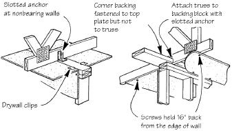

When appropriate, “floating corners” should also be used to minimize the possibility of cracking at wall and ceiling intersections (see illustration, above).

Specific solutions should be handled on a case-by-case basis. In the majority of the cases, retrofitting floating corners with appropriate back-blocking solves the problem. Care should be taken to remove the fasteners attaching the wallboard ceiling to the trusses within 16 inches of the wall-ceiling corner.
A second possible solution is to install cove molding at the corner. Make sure to attach the molding through the ceiling to the trusses but not to the partition. This allows the partition to move independently of the molding; any gaps that occur between the partition and ceiling will be covered by the molding.
