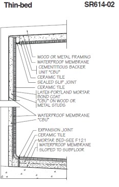

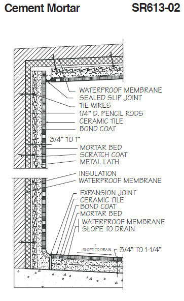

I suggest that you obtain a copy of the TCA Handbook (864/646-8453, www.tileusa.com) for details on steam showers and other ceramic tile installations. In the meantime, see the illustration below.
Requirements:
  • steam rooms require a waterproofing membrane on all surfaces to prevent moisture from penetrating adjoining spaces.
  • some membranes will require insulation on walls and ceilings to protect them from excessive heat.
  • slope ceilings (2” per ft. minimum) to avoid condensation from dripping onto occupants (sometimes sloped to center to minimize rundown on walls).
Material and Tile Installation:
  • attach four equally spaced tie wires to the supporting members and through the insulation. Attach 1/4” D steel pencil rods vertically over the insulation. Attach metal lath to pencil rods on both walls and ceilings.
  • install open slip joints in all corners between walls and ceilings and to divide areas that exceed 16’-0” in length.
  • floors—follow Method F121.
  • walls and ceilings–follow Method W221.
NOTE: Waterproof membrane is shown in two different installation locations on wall. Specify one or the other.
Requirements:
  • slope ceiling (2” per ft. minimum) to avoid condensation from dripping onto occupants (sometimes sloped to center to minimize rundown on walls).
  • waterproof membrane must be capable of withstanding heat exposure.
.Material and Tile Installation:
  • tile—A137.1 and certified by manufacturer for wet environment.
  • cementitious backer units—ANSI A108.11 and A118.9.
  • bull; reference and follow membrane manufacturer’s installation directions for placement of membrane.
  • install open slip joints in all corners between walls and ceilings.
  • floors—follow Method F121 or F122
  • walls and ceilings—follow Method W244 or B415.
NOTE: Any penetration of the membrane should be sealed with appropriate sealant before installing tile.
Courtesy of the Tile Council of America, Inc., © 2002
