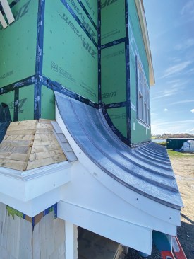

On a recent house build, we were confronted with a detail typical to the coastal, Shingle-style homes we are known for—a small, pop-out roof to protect the garage door opening from weather. The architect had originally drawn this as a straight-hip roof that would be shingled with wood. On this particular home, however, we were using an Eastern-white-cedar sidewall shingle that couldn’t be carried over the roof. (In the past, we’d done this with Port Orford cedar shingles that performed well on a roof exposure.) To overcome the problem, I gently suggested to the architect that we install a flared, standing-seam-metal roof instead. He embraced the idea, pitched it to the client, and we set to work.
Framing and Trim

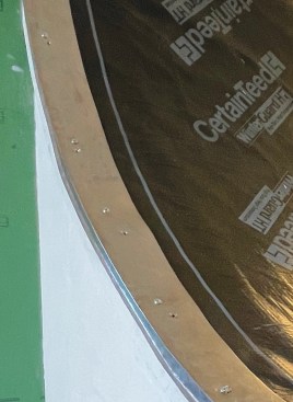

We began by building a 2×8 substructure (ledger, blocking, and subfascia) that we affixed to the wall with SDS screws. To define the stepped soffits, we capped this framing with Versatex cellular PVC on the bottom and top. The top provided a base for attaching curved ribs built from two layers of 3/4-inch CDX plywood. The concave roof surface was made with 2×4 furring strips running horizontally over the ribs. Making this segmented surface proved much faster than bending multiple layers of 1/4-inch plywood (which we have done in the past) and resulted in a sturdier structure. We finished out the rake ends and fascias with Versatex, as well, bringing it right up to the top edge of the furring strips so the metal roofing would cap the top edge of this trim.

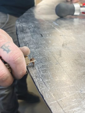

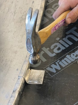

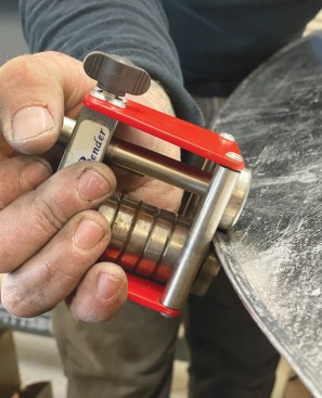

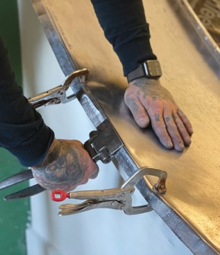

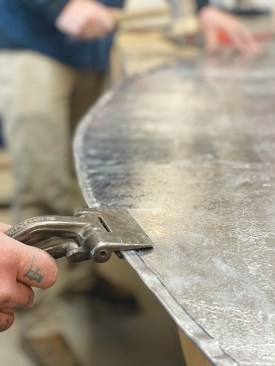

Curved Standing-Seam Metal

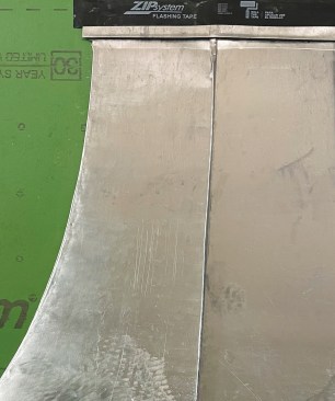

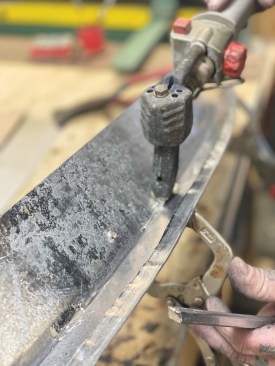

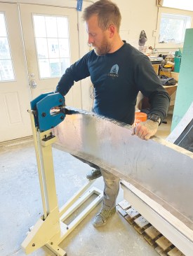

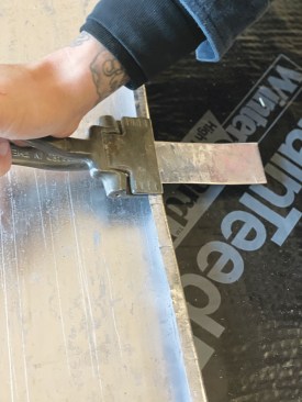

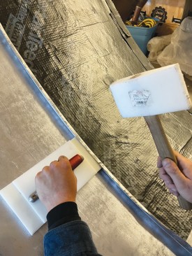

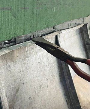

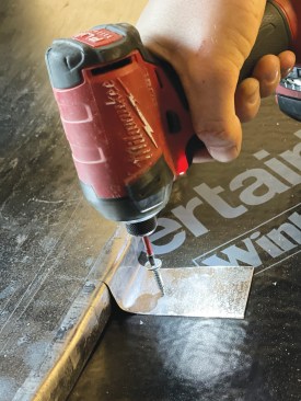

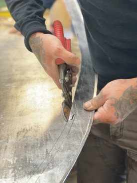

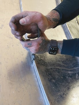

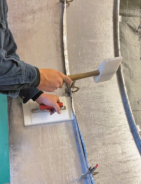

At this point, we turned the task of forming the concave standing-seam-metal roofing over to Kyle Ouellette of Liberty Building Envelope. Using lead-coated copper, he and Kory Demello began with the rake drip edges—the hardest and most time-consuming part of the job. Making these two rake pieces for each side of the roof easily consumed about 70% of their time. To illustrate the process, we did a full mock-up in Kyle’s shop to photograph for this article. For the actual job, the rake pieces and curved pans were cut and formed in his shop, but all the seaming work was done in the field. Ordinarily, the pans would be installed in the field beginning at the center and working out in both directions to each rake end.
The finished flared roof, with the top edge of the transition flashing taped to the sheathing with Zip System tape.
