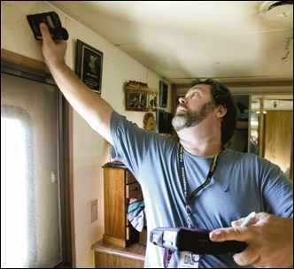

Garry McAlpin, an inspector under contract to FEMA, inspects a home damaged by Hurricane Charley.
The hurricane shifted the 1930s-era waterfront home off its pilings, sending them shooting through the living-room floor. That much was clear. Wilbur T. “Dusty” Yaxley’s job was to find out whether the storm’s winds or surge were to blame.
Yaxley, of Seffner, Fla., is among a small cadre of structural forensic engineers whose date books filled as four hurricanes struck Florida last fall. Their job: To distill, from a home’s jumbled and sodden remains, the drama of how wind, rain, flooding, construction, materials, or a combination led to its demise. Hired by insurers, homeowners, or builders, forensic engineers typically help settle private disputes about who should pay for repairs. But as building costs escalate and a river of new non-field-tested materials reaches the construction market, they’re also playing a bigger public policy role.
Yaxley noticed that although water entered the house, the waterline was near the floor, suggesting the surge’s force wasn’t sufficient to move the structure. But what cinched the case was that the line was not parallel to the floor, meaning the house was already listing off the pilings before it flooded.
End result: The wind insurer had to write the check.
