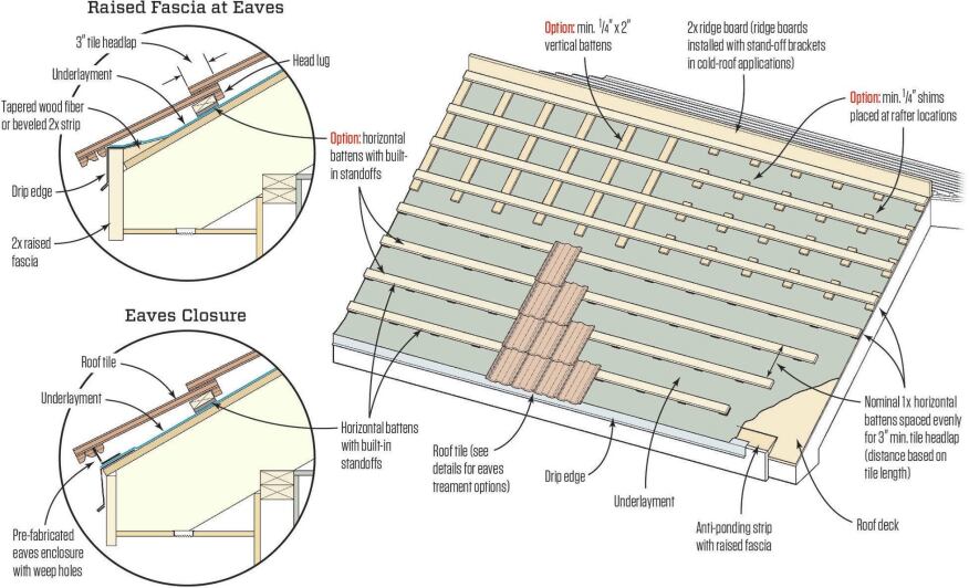

Sheathing Options for Tile
A tile roof can be installed either over a solid sheathing or spaced sheathing.
Underlayment Options for Tile
  • For slopes 4:12 and over, solid sheathing and 30-lb. felt will do. See Underlayment for Tile Roofs, below.
  • On solid sheathing, 1×2 battens are mounted to the roof deck over the underlayment and between the roof eaves and the ridge. Battens are required on roofs with slopes in excess of 7:12, and are generally recommended on all tile installations. See Underlayment and Batten Layout, below, for underlayment application over solid sheathing.
  • Check manufacturers’ suggested layout procedures. Each manufacturer should supply information regarding batten spacing and kick-strip installation, as well as a layout calculation chart for its product.
  • Tiles on shallow slopes must be installed over a waterproof low-slope roof, either built-up or single-ply. In this case, the tiles are mostly decorative, although they do shield the membrane against ultraviolet light, high winds, and mechanical damage.
  • Flat concrete tiles should be installed over preservative-treated battens (Eaves Details for Roofing Tile, below). In climates with snow accumulation, install the counter battens over battens that run from ridge to eaves (Underlayment and Batten Layout, above). These enhance drainage and ventilation, and help to keep the roof uniformly cold, which lessens the chance of ice damming.

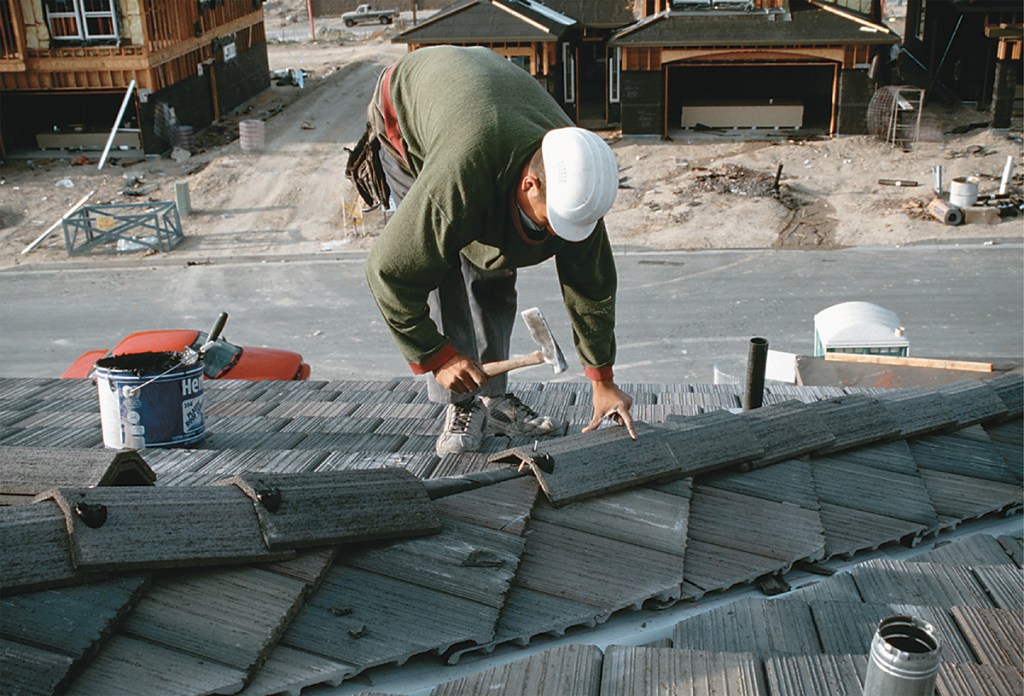

Cutting Tile
Straight cuts at rakes can be made by scoring a line on the tile, then breaking it with a roofing hatchet. Although this leaves a rough edge, it will be covered by the rake tiles.
Valley and hip cuts. Use a power saw — a cut-off saw or a standard tile saw — and a diamond blade. Tiles may be cut wet or dry. When dry cutting, workers should wear respirators because of the fine dust. Also sweep any accumulated dust off the roof so that it does not stain the tiles or cause a fall.

Cold-Climate Tile Roofing
In cold climates, build a “cold roof” using counterbattens, whether or not the attic is ventilated.
The steeper the roof, the better. A steeper roof will reduce snow loading as well as promote airflow through the counterbattens.
Counterbatten System
  • Use 2x vertical battens with the eaves intake and ridge outlet baffled to keep out wind.
  • Depending on snow accumulation and roof pitch, 2x cross battens may be required to support snow loads. In extremely cold and snowy climates, or with long, low pitch (around 4:12) roofs that require more ventilation space to promote airflow, vertical battens taller than 1 1/2 inches (for example, 2x4s on edge) may be required. Be sure to consult an engineer for this application.
  • Brackets may be needed to prevent tall battens from tipping under live loads.
  • When the attic is ventilated, install ridge boards with standoff brackets to allow attic airflow to exhaust.

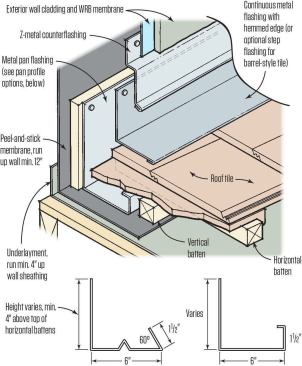

Flashing
Flashing for tile roofing must serve two purposes: 1) to limit the amount of water that gets under the tile, and 2) to keep water out of the roof deck. This requires a dual-layer flashing around penetrations and at roof-wall intersections.
Where the roof meets a sidewall, extend underlayment at least 4 inches up the wall and add a wide peel-and-stick that extends up the wall as well as onto the roof plane. Use a metal flashing with an upturned edge to contain water. It should be padded out from the wall to allow for a robust counterflashing.

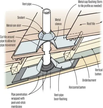

Vent pipes need to be flashed above and below the tile.
