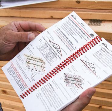

What I did have to do immediately was create a written safety plan. OSHA had let me know beforehand that my meeting would go better if I showed up with a written plan in hand, so I had purchased a generic one on the Internet and customized it with some of my company’s details. That’s the plan I still use today. Even though it’s boilerplate, I’ve found it to be practical and useful for training my crew and planning out the methods we use on any particular task.

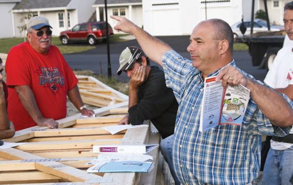

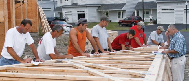

The safety plan is a fat document — almost 400 pages. But my employees don’t have to read and study the whole thing in one go. Short individual chapters and sections cover the basics of various operations on the job. So the day before we’re framing walls, for instance, or setting trusses, I can say, “Take a look at such-and-such a chapter this afternoon, and we’re going to talk about it in the morning.” It’s been an effective way to keep everybody aware of the rules.
