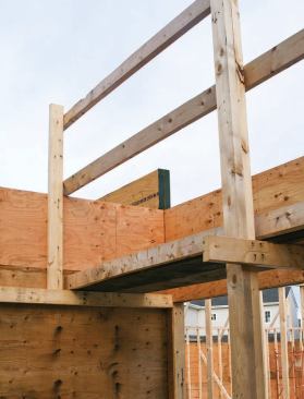

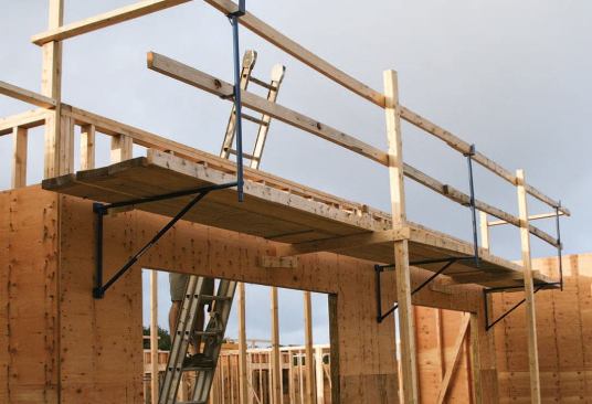

Beyond the training and the organizational adjustments, I had to invest in some equipment. I spent some money on scaffolding, including outrigger staging like that shown at the top of the facing page.

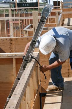

I’m not going to try to describe all the safety rules contained in the 10-hour OSHA course, or all the items covered in our written plan. You should take the course yourself, and you need your own written plan. But I do want to explain how we now handle safety in the situation we first got busted for: setting trusses. This fall, we happened to be framing a roof on the same development where I was previously cited for violations. So we had a chance to do everything right that we had been doing wrong the day we got in trouble with OSHA. The photos in this story are from that day’s work, with our full safety plan in place.
