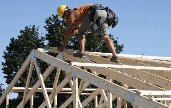

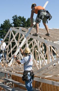

Two carpenters have to move up and down along the top chords of the trusses, setting spacers, installing bracing, and unhooking the crane. And they have to do this work before the whole system is fully braced. They’re in a risky position, especially at the beginning; there is no way to tie them off to anything, or to give them a conventional scaffold to work from.

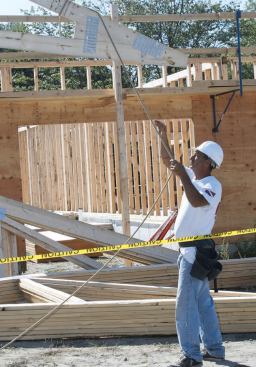

To make this work safer, we stabilize the trusses as much as possible before the men climb on them. As each truss is placed, the crew attaches 2-foot spacers to set the truss spacing. But those spacers are not bracing — they’re not strong enough to provide adequate structural stability. Still, they add some stability, and we get them in place before unhooking the crane. As soon as enough trusses are in place to provide room for the temporary structural braces, the crew sets those braces, working from the bottom up.

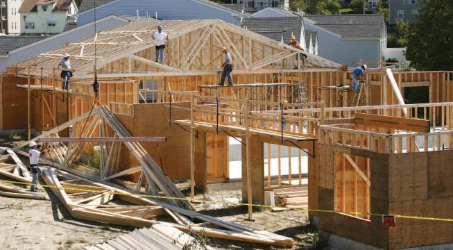

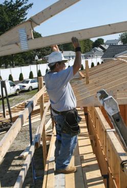

Also, on this job, we set up rolling pipe staging with plywood and plank platforms below the work area. The plan was to move this staging along as the work progressed, so that it would remain below the leading edge and provide a midheight platform to break the fall of anybody who slipped. Since it was only 6 feet off the ground, the rules did not require railings for it — which is good, because railings would have gotten in the way of the trusses. The rolling staging also provided a midheight work platform for Eric, so he could pass materials to the guys at the peak and assist them in any other way they needed.
