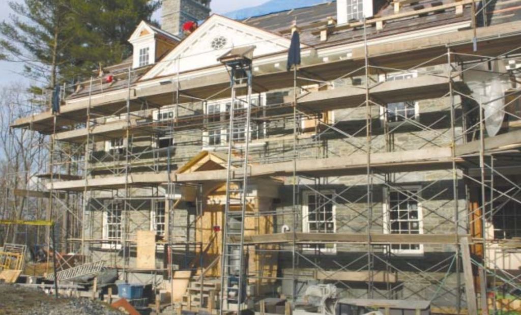

As a masonry contractor, I set up and use fabricated frame scaffolding every day. It’s an integral part of my business. Frame scaffolding — also called “pipe” or “tubular” scaffold because it’s made from welded steel tubing — provides an easily erected elevated work platform with enough area to move freely and sufficient protection to prevent missteps.

The fundamental key to trouble-free scaffold assembly is to begin with a firm and stable foundation. Always use proprietary steel base plates or adjustable screw jacks on all first frame sets. Screw jacks are particularly useful for leveling the first frame set on an irregular grade — and they are the only leveling system you should use. Never use stacks of wood or concrete block under the legs to level the frame, because wood blocks can slide or topple and concrete block can shatter when loaded.
The base plates or screw jacks should be placed on wood “mudsills” having a minimum 1-square-foot dimension. Typically, we use 18- to 24-inch lengths of 2×10 lumber under each plate. Whenever it’s practical, we shovel the grade level across frame ends to minimize excessive jack adjustments (no more than 12 inches), which can introduce instability.
Once we’ve leveled and squared up the first frame set, we nail the plates to the mudsills. Always use base plates and mudsills, even when setting up staging on a wood deck, concrete slab, or asphalt paving, to prevent the tubes from punching through the surface under a heavy load. And never use scaffold planks for mudsills or vice versa. It’s a good idea to clearly label mudsill planks as such to prevent their misuse.
As scaffold height increases, safety codes require you to physically secure the scaffolding to the building structure vertically at four times the narrowest base dimension. So, for a 5-foot-wide frame, you tie in at the 20-foot height, and at every 20 feet of height thereafter. According to OSHA, these vertical ties have to be repeated at horizontal intervals no greater than 30 feet starting from one end of the staging. Those are minimum specifications; we tie in at a height of 16 feet and at 16-foot intervals thereafter, and at every third frame horizontally.
Ties have to resist movement both in compression and tension, so they have to be rigid — wire alone isn’t suitable, although #9 wire is acceptable for tensioning a tie against the wall. Tie-in brackets come in various types; most clamp on to the staging and are bolted to the building. Naturally, bolt placement is important. On wood walls, we locate solid framing and bolt into that, not just into the sheathing. Masonry walls often require drilling for expansive bolt anchors; in that case, we locate the anchors in the mortar joints and repoint the holes after the scaffolding is removed.
Standard staging frames come in heights ranging from 2 feet to 6 feet 6 inches and measure 5 feet wide. Staggered frame heights are useful for setting up a level base course on steeply sloping grade and for adjusting tower height to overhead work (Figure 3). Narrower frame sections are also available in 4-foot, 3-foot, 30-inch, and 24-inch widths, for staging narrow spaces.
Erecting frames is easiest if you start with the braces on the bottom locks first, then tilt the frames up toward one another and connect the top brace locks. We immediately plumb, level, and square the first frame set, because it makes aligning and stacking successive frames much easier. After we set up a run of starter frames, we stretch a string line from one end to the other at a common attachment point — typically the bottom lock studs — then use the screw jacks to adjust all the frames to the line.
