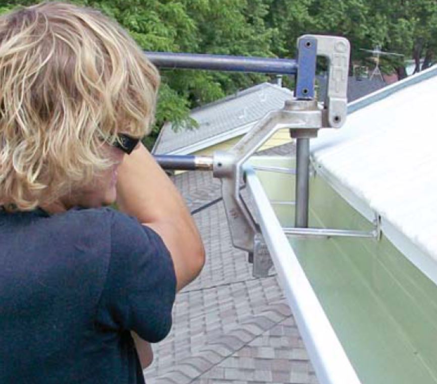

Gutter Installation
Old-style wood and yankee gutters caused a lot of damage because when they leaked, the water backed up into the eaves. This promotes decay in the rafter ends and the soffit. Modern metal and vinyl gutters do a much better job, but there is still the potential for problems if the gutters are not installed with the proper clearances (Gutter Location, below).
Place gutters below the roof’s slope-line so that ice and snow can slide by.
In cold climates, the outside edges of all gutters should fall below the roof’s slope line so snow and ice can slide clear. The shallower the roof, the more clearance is needed.
Hanger Types
There are three common hanger types (below). Of these, strap-type hangers that hold the gutter away from the fascia provide the most protection against decay.
Installation Details
  • Aluminum gutter runs should have an expansion joint every 40 ft. of straight run since the gutter will expand and contract 1/8 in. or more over that span.
  • Gutters should slope at least 1/16 in. per foot of run. It is important to move the water quickly away from the foundation with either a subsurface pipe or splash blocks and by sloping the grade at the surface.
  • The number of downspouts a roof needs will depend on the size of the conductor pipe. Allow 1 sq. in. of downspout cross-section for every 100 sq. ft. of roof area. Place the downspouts at least 20 ft. apart but no more than 50 ft. apart.
