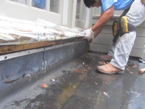

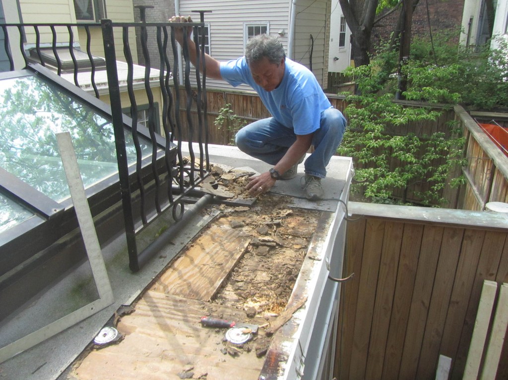

Windblown rain penetrating through flashing gaps at the roof edge has damaged the plywood roof sheathing underneath this membrane roof. Sealing joints carefully while providing for metal to expand and contract can help prevent this problem.

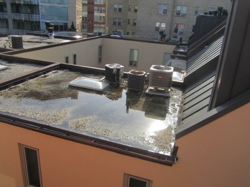

Slope is very important! One-quarter inch per foot is the code minimum, and it’s a very good idea. Any less, and ponding is inevitable—and with it, freeze/thaw, biological growth, and a ready reservoir of water waiting for the tiniest opening to pour through.
Inadequate slope and poor drainage allows water to pond on a flat roof. The result: biological growth and an increased risk of leaks.
Doug Horgan/BOWA

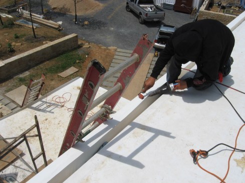

A roofer screws down tapered foam insulation from a "roof kit" while preparing the deck for a membrane roof. Sloped roof kits don't cost much more than ordinary insulation, so they're a cost-effective way to achieve the appropriate slope.
Doug Horgan/BOWA
In remodeling situations, it can be hard to provide sufficient slope. We are often trying to fit a roof between a second-story door and a first-story ceiling height. It can be tempting to reduce clearance at the door sill, or to use less than 1/4-inch-per-foot slope. While the commercial “by the book” clearance at doors is 8 inches above the roofing, in my experience less than 4 inches is where it seems to cause problems in our climate. Four inches is also close to the minimum for good working room between the threshold and the roof plane. So, start with a 4-inch drop at any doors or windows, and slope down at 1/4 inch minimum.
We like to buy “slope kit” foam boards from a roofing supplier. These tapered pieces of insulation can give flat framing a perfect slope. The expense compares favorably to our standard closed-cell spray foam, so it may not even add cost.

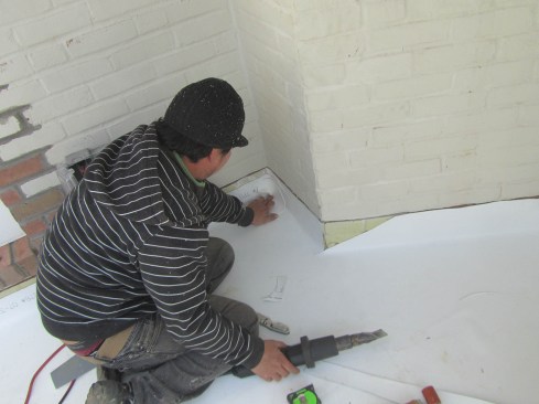

TPO is another single-ply membrane, and we’ve been using it more and more. TPO seams are heat-welded: The installer warms up both sheets with a special heat gun and hand-rolls the layers together. The sheets become one in the process, and these seams don’t require maintenance. For that reason, TPO is a better choice under decking or pavers, where access to maintain seams may be limited. Some clients also prefer the white, beige, or gray colors of TPO to the black EPDM. When we put decking over TPO, though, we often lay a sheet of EPDM on top first, because the black rubber is less noticeable.

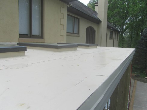

Edge Connections
The main issue I’ve seen on edges is that metal always leaks at joints. We’ve been brought in to repair leaks at metal drip edges, parapet caps, and even skylight flashings. As we know from metal roofs, metal changes size significantly over the seasons. This puts a lot of stress on the joints between pieces. Two 10-foot-long drip-edge flashings will move a lot, breaking any seal between them and allowing water to work its way through the joint.
The general principles for keeping water out are to slope things well below the metal and to run flexible roofing materials under the metal and down the vertical surface. The first reduces the leaks; the second sends any leaking water out of the building.

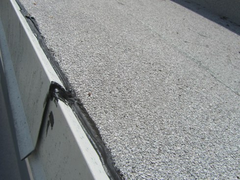

The edge metal on this roof was applied before the roofing. Water leaking at this point will go into the building.
Doug Horgan/BOWA

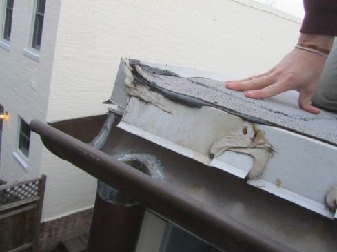

Metal drip edge moves almost 3/8 inch in 10 feet as temperatures change between summer and winter—too much to effectively seal. The large gap shown here illustrates how far this kind of joint can open up

On a drip-edge situation, choose a detail where the membrane runs over the edge and down the fascia. The edge metal is applied over the membrane, and flashing tape is applied on top. Any minor leaks between metal pieces are handled by the first layer of membrane. Firestone has a good published detail for this situation.

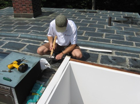

For parapet walls and skylight curbs, run the roof membrane all the way up over the top of the curb and down the other side. The metal parapet cap covers the last bit on a parapet, but for a skylight, you may need to get creative with finishes on the inside. Curb-mount skylights often include or require aluminum “pans” with a turned-up inner edge. If the skylight curb has a slight slope to the outside, and the metal is sealed well to the membrane at the innermost edge, then almost any leaks between pan segments will run down the slope and outside. On a job with an indoor pool, we ran the membrane all the way to the inside of the trim so any water leaking through would drip into the pool, but most skylights don’t offer such a convenient option.

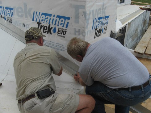

The key at walls is to prevent water from getting behind the roofing material. It seems obvious, but don’t forget there’s usually a drainage plane buried behind the wall finishes, and if it can’t drain out onto the roof, you’ll have a leak.
It’s common to find brick or stucco on a wall we’re tying a roof into. If we want to be sure there will be no leaks in windy rainstorms, we need to remove the finish and install a through-flashing above the roofing tie-in. The same is true for siding. All of these claddings should have felt or housewrap behind them. We pull this layer out in front of the through-flashing or the roofing, so any water running down it lands on the roof.

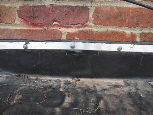

The roof tie-in is fairly straightforward. In our area, it’s common to glue the membrane to the wall and install an aluminum flashing to cover the top edge. We’ve seen a fair number of leaks where this technique has been used, though, so following the manufacturer’s details, we normally use a “termination bar”—an aluminum extrusion that’s nailed to the wall and pinches the roofing in place. The top of the joint is caulked, and then a flashing is applied to cover all of that. When water makes it past the flashing, the caulk and the bar keep it out of the roof.
When we work on an older building with solid masonry walls, we cut a horizontal slot into the masonry just above the roofing and slide the flashing into the kerf. We’ve found that ³/₄ inch is the “right” number. Any deeper, and you can be opening a pathway for water into brick cores or poor head joints; any shallower, and the roofer may not get enough metal into the kerf. When we used to ask for ¹/₂ inch, sometimes the slot would be only ¹/₄ inch deep—then on a hot day, the metal would be prone to “oil can” itself out of the slot, leading to a leak.
One thing we won’t allow is metal applied only to the face of the masonry without cutting in. This does not work in our climate—hot days invariably push the metal off the wall, no matter how great your preferred brand of caulking is.
We also insist on stopping cladding materials well above the roof surface. For splashing, snow and ice, and wind, we want 8 vertical inches on the roofing material that turns up the wall. In addition, many claddings require clearance above a flat surface. While
2 inches is the normal distance for roof clearance (with fiber cement and wood siding or stucco, for example), often the recommendation is 4 inches or 6 inches from a deck or paved area. It’s safer to use the larger clearance, to avoid splash staining and the added wetness that comes with proximity to a horizontal surface.
Another reason to leave ample clearance becomes evident down the road, when it’s time to re-roof. If we’ve left only a couple of inches of clearance above the roof, it’s hard to get the new roofing material turned up the wall properly. Taking a page from a Hardie install guide, we often bend up a piece of metal to visually fill the space between the roof and the cladding while leaving room for later repair or replacement.

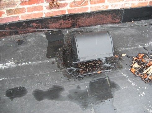

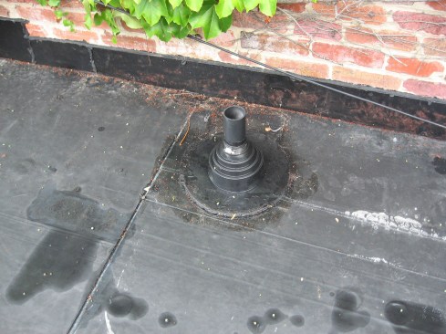

Penetrations

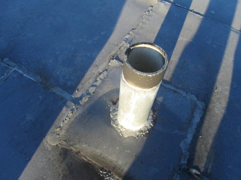

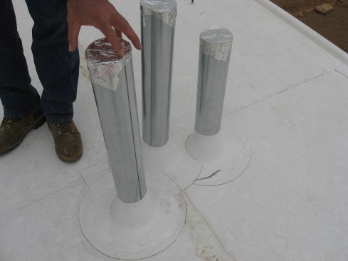

The best way to handle penetrations is with factory-made “boots.” These are flexible, reliable, and easy to install. It’s often best to plan penetrations so these can be used; for example, by using round steel posts to mount solar panels and satellite dishes. Trying to use square or I-section bars creates extra sealing work and more chances for a leak to form. Of course sometimes we have a shape there is no boot for. Roof manuals include details for larger round shapes, and rectangular ducts can be treated the same as skylight curbs.
Another method for penetrations is a “pitch pocket.” A small curb is formed up around the penetration using roof membrane or flashing tape and filled with a liquid that cures into a watertight barrier. These are a bit expensive to make, and in manuals they’re said to be less reliable than a boot. I also find that many roofers aren’t aware of details such as priming the surfaces the liquid needs to adhere to, and forming a slope on the top of the liquid as it cures. Still, pitch pockets are useful where a boot can’t be installed.
